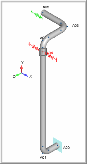

Let us consider this simple example: Let us assume you have vertical pipe with a horizontal support that has gaps of 1” on each direction.
Let us also assume that under operating conditions (T1) the pipe moves 0.8” in the +X direction. That means the pipe can only move 0.2 inches for wind in +X and 1.8 inches for wind in –X direction. That is assuming the wind load acts under operating load. If however, the wind is acting under shutdown or ambient temperature, the displacements due to wind can be a full 1” in each direction. Let us assume W1 is in the +X direction.

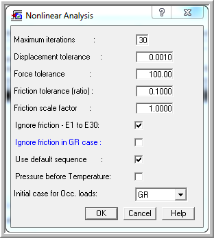

(1) Analyze the system by applying occasional load under NON-OPERATING condition
This can be done easily using the nonlinear analysis option:
Initial case for Occ. loads: GR
This is the default in most cases in AutoPIPE. AutoPIPE will automatically create code combination Sus+W1 for stresses. It also creates a consistent non-code combination GW1 for support forces and displacements. In this case displacements GW1 are limited to +1 inches for our wind example. If you manually create a user case GW1+T1 then this is not consistent with the selected initial state and would have displacements up to 1.8 inches. So DO NOT manually create GW1+T1. Instead do the following:

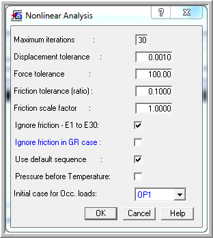

(2) Rerun the analysis with occasional load under OPERATING condition:
Initial case for Occ. loads: OP1
AutoPIPE will automatically create code combination Sus+W1 for stresses. This W1 is different from the one obtained under the previous sequence or initial state since it is evaluated using GT1W1-GT1. The previous one was evaluated from GW1-GR. AutoPIPE also creates a consistent non-code combination GT1W1 for support forces and displacements. GT1W1 will correctly be limited to 0.2 inches in this case. In this case the displacements would not exceed specified gap limits for supports.

Analyze using the option
This will automatically create 4 occasional code cases (for stresses):
Sus+W1
Sus+W2
Sus+W3
Sus+W4
And 4 consistent non-code combinations (for support forces and displacements):
GT1W1
GT1W2
GT1W3
GT1W4
These load cases will be consistent with support gaps and friction limits.
If you also want wind loads under non-operating conditions, you would need to do a separate run with initial state option changed to:
