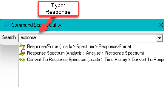

With an AutoPIPE model opened, search for command to launch the Response/ Force Spectrum dialog, use mouse to select the first option in the listing:

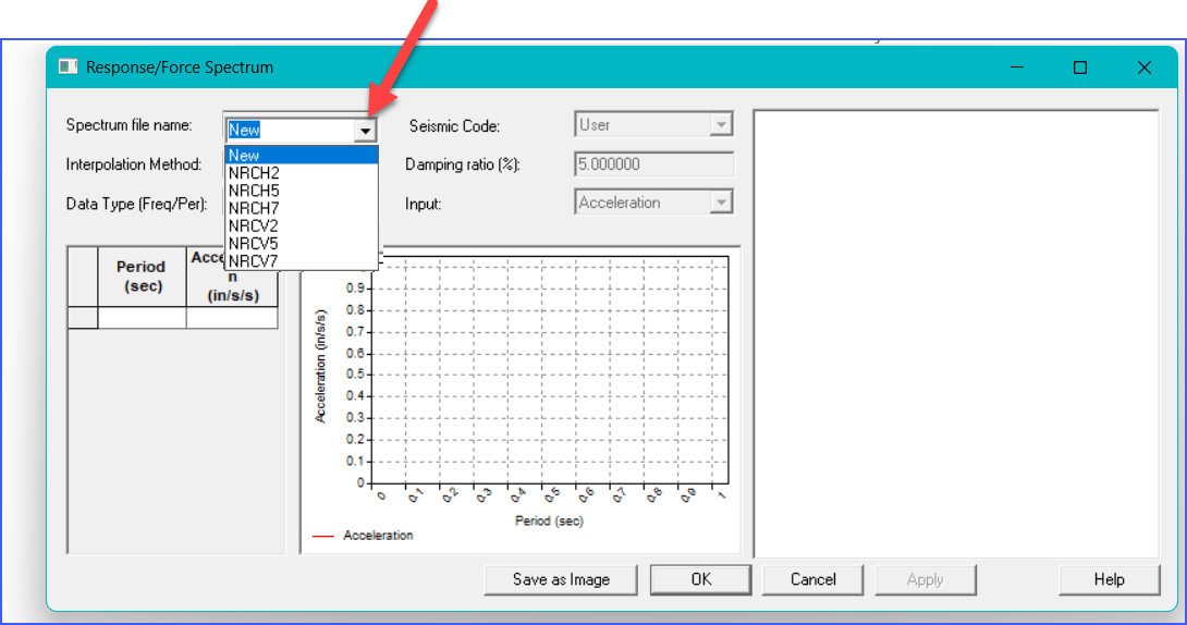

Next, with the dialog opened, one can view any existing .SPC file already created and saved to the same folder location as the model currently opened. One cannot browse for a SPC file in other folder locations. Again, the file must be in the same folder as the model. From the drop down listing, select an existing .SPC file to be opened and graphically viewed:
Otherwise, overwrite the word New with a file name of the NEE *.SPC file to be created.
Configure the Spectrum as needed, refer to AutoPIPE help for details on any field.
And finally press OK to save any modifications made to the spectrum or to close the spectrum dialog.
