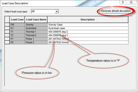

For AutoPIPE 09.06.00.15, Under Load> Load Case Description, the description displayed for load case does not respect the units used in the model for example in joined file: t1 = 207 °c and load description displayed by autopipe is : 404.59999 °c, which the the temperature value in °f. the same issue occurs for pressure description.
How to fix?
Answer: This observation is correct and acknowledged by the development team to be fixed in the next version of the program AutoPIPE V8i 09.06.01.xx and higher.
Workaround, manually update the text on the dialog screen.
