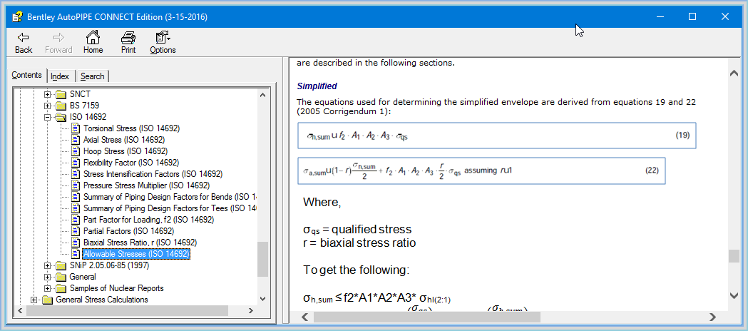

Please see the following AutoPIPE help section for general Code equations used by the program:
Help > Contents> Contents Tab> Reference Information> Code Compliance Calculations> ISO 14692> select a topic (ex. Allowable Stresses)

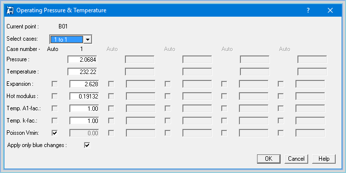

The expansion coefficient, along with other ISO 14692 specific inputs, are located on the Operating Pressure and Temperature dialog box:
Select All or part of an open model that is using ISO 14692 piping code and under Modify> Operating Pressure and Temperature> enter values as needed:

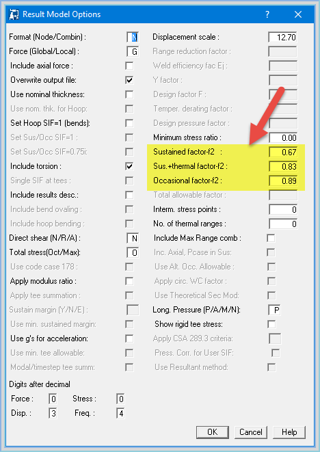

The f2 factor for the 3 different stress categories is found in the Results Model Options (Tools>Model Options>Result) dialog box:

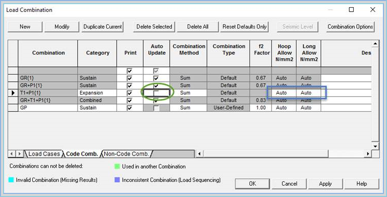

As for the expansions allowable:
AutoPIPE does not calculate the expansion allowable for ISO 14692, as this allowable is not provided by the code.  Only option to enter in a user allowable for any expansion cases by going to the Load Combination  (Tools>Combinations) dialog box, unchecking “Auto Update” in any expansion case and inputting the allowable values based on the units for that column.
