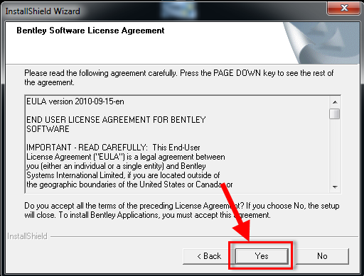

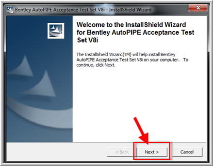

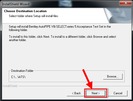

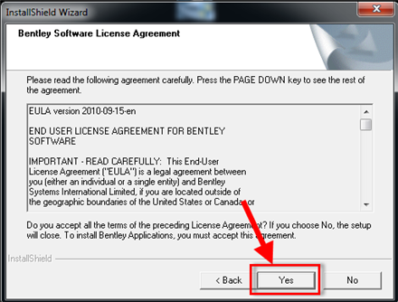

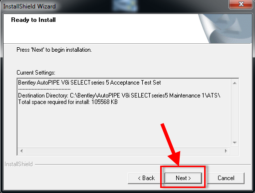

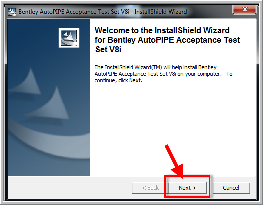

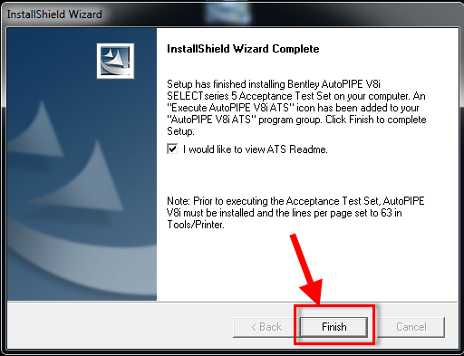

Step #3: Installation dialogs and User interaction (by default)

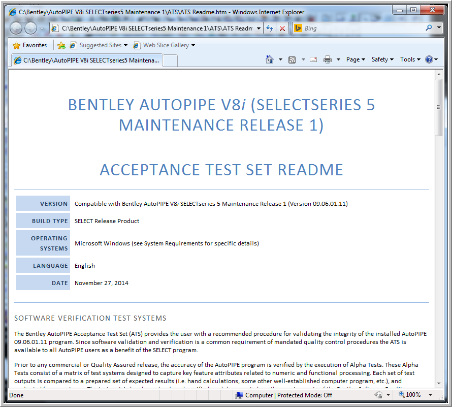

The following is automatically displayed after pressing Finish button, select the hyperlinks to see complete details about this version of the program.
Step #4: Finish with AutoPIPE V8i ATS install
