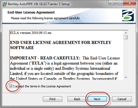

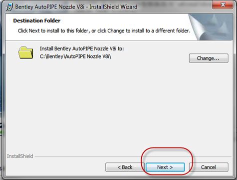

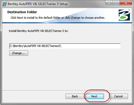

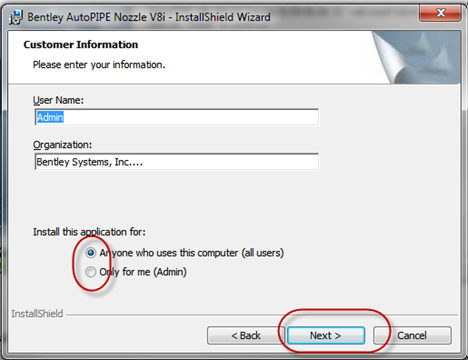

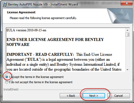

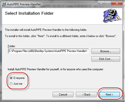

3. Suggest that AutoPIPE V8i is installed while accepting all the default settings.
a. Prefer that the application is not installed over a network connection; suggest that the EXE file is on the users system before starting the installation.
b. If you have already installed AutoPIPE V8i, using add/remove programs uninstall:
" all previous versions of AutoPIPE
" PCF to NTL translator
" ADLPipe to NTL translator
" Bentley STRAIT
c. Navigate to the EXE file download using the procedure above.
Default:  C:\Downloads \Bentley \

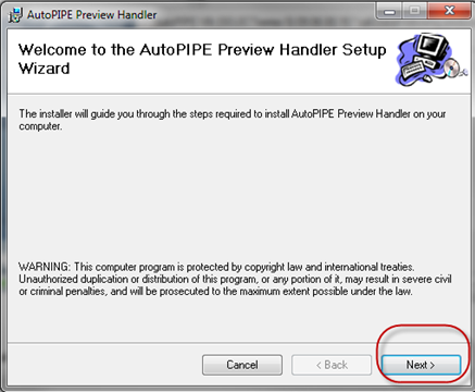

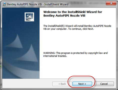

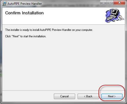

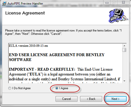

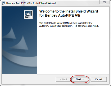

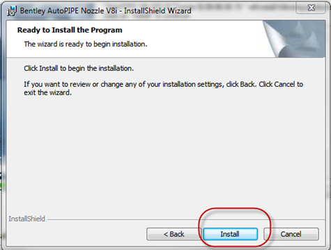

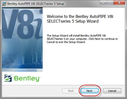

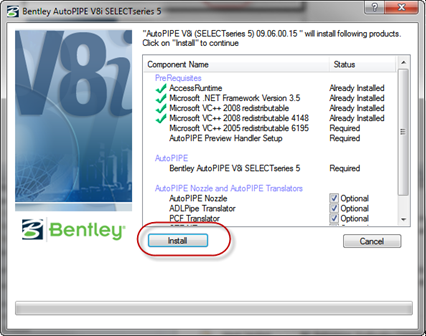

d. Double click on the "ap09060015en.exe" to start the installation process.

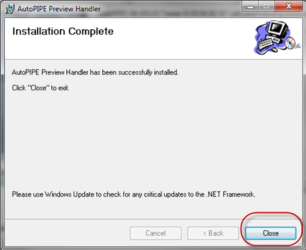

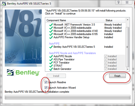

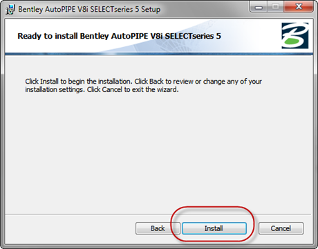

Note: Be patient while the application is installing as it is checking to verify programs already installed, verifying drive space, etc.. there may be periods when it appears nothing is happening. Give the system time. In the event the installation stops a warning / error will be presented. Just follow the prompts and be patient. Highly recommended that all applications are closed during the installation process. On average it will take 6-8 min to install everything.

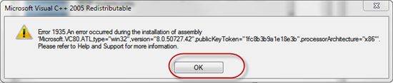

Wait for the application... it is working in the back ground
the following may or maynot appear,  just press OK button

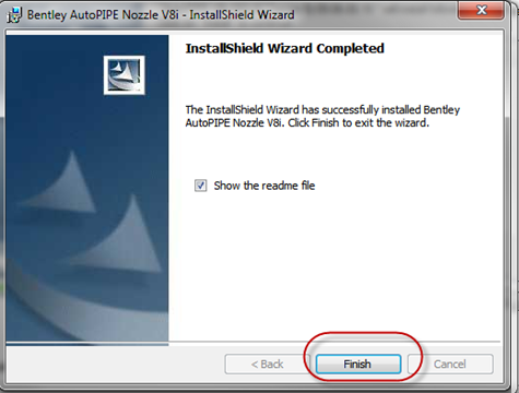

e. Finished, with AutoPIPE install, continue to STEP #3: Set-Up Licensing before starting the application

    2. Install to the default locations (do not select a different installation drive location, known issue to crash
            the installer)

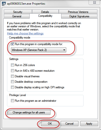

    3. Modify Setup Properties: Compatibility mode.
d. Modify Compatibility settings: Run program as Admin

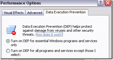

f. Turn off DATA execution
Turn off data execution protection before installation of AutoPIPE
