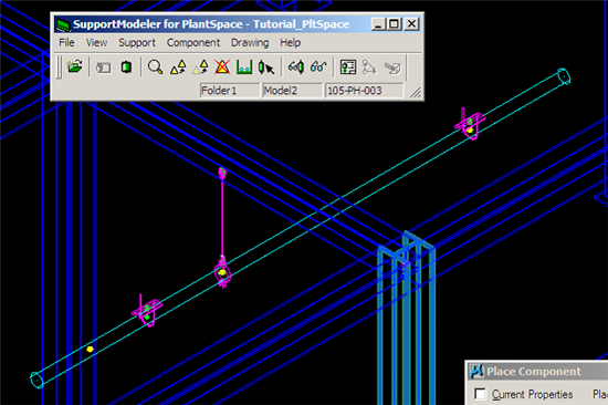

PSDS to AutoPIPE Supports:
Use PSDS Support Modeler to place supports

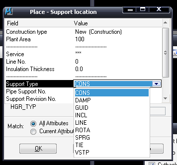

Select the AutoPIPE support type when placing the support using support modeler

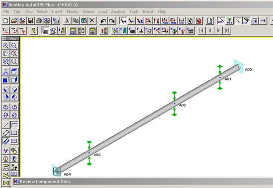

When the model is imported into AutoPIPE, the support is converted to the correct AutoPIPE support as specified in the PlantSPACE support modeler, indicated above.
