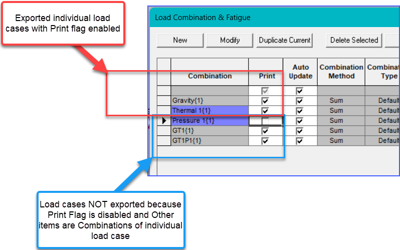

It appears that the loads in AutoPIPE are not being exported to STAAD. Why?

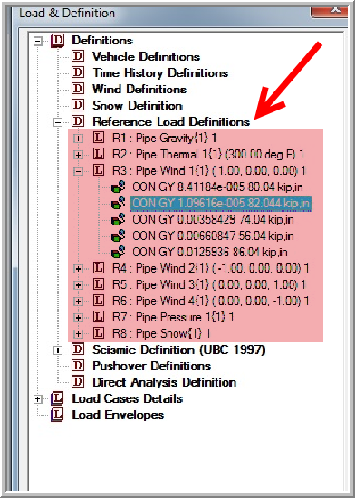

Remember that all loads from AutoPIPE are imported into STAAD as reference Loads
At which time they can then be reconfigured as regular loads in STAAD (see STAAD online help for details).
Further reasons why load cases may not appear in STAAD:
      1. No combinations are exported to STAAD, only individual load cases. ex. GR, T1, T2, T3, E1, E2...
        2. Only those load cases that are visible and set to print on the Combination dialog> Non-code combination will be exported to STAAD.
