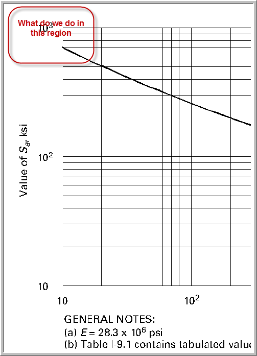

02. Since the fatigue data is tabulated such that at the highest tabulated stress, 10 cycles are all
Product(s):AutoPIPE
Version(s):2004, XM, V8i
Area: Reports
Date Logged
& Current Version
Feb. 2015
09.06.01.10
Since the fatigue data is tabulated such that at the highest tabulated stress, 10 cycles are allowed, what AutoPIPE will do if the upper tabulated stress is exceeded. So what does AutoPIPE do at the low cycle end of the curve?
 If the calculated stress value exceeds Maximum stress from fatigue curve, AutoPIPE will return number of cycles as 1
