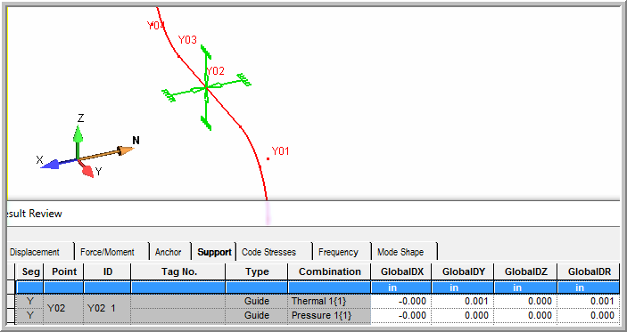

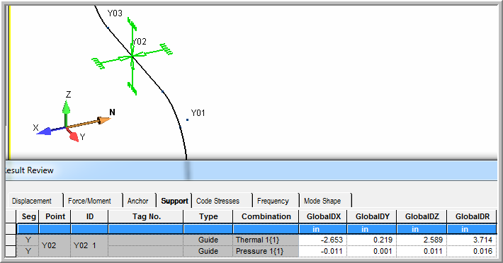

When reviewing the results of a guide support with gap in the horizontal (global X-dir) and vertical (global Z-dir) set to 0.00 inches during a non-linear analysis, noticed that the support was moving with the pipe.
Deflected shape for T1 load case:
How can this be happening?
How to fix it?

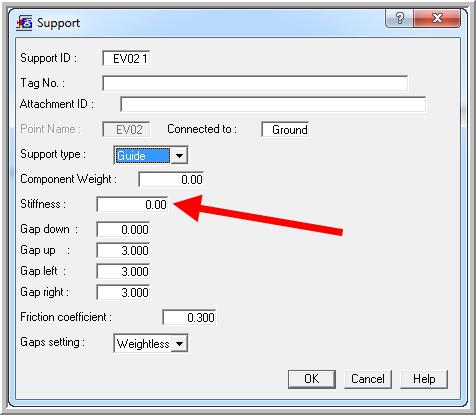

Reason #1:
Check the Support tab on the Input grids see the "Rate/Stiff" column or open the Support Dialog screen, check the "Stiffness" settings:
Note: A support with a Stiffness = 0.00 (as shown above) will offer no resistance to the pipe movement.
Avoidance: Enter a suitable value or set to "Rigid"

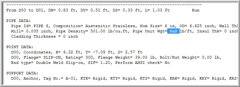

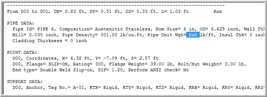

When reviewing Tools> Model Input listing, Extended Component sub report, the following was found in multiple PipeID's in the model : "NaN"
Note: Something has happen to this model and the results should not be trusted while "NAN" can be found in a complete output report with all applicable sub-reports checked ON or while searching a complete model input listing report.
 If you encounter this issue, please try to write down exactly how this was accomplished or provide as much model history as possible (created in what version, how was the model created, import , copy clip, what commands were in use, etc..) then create a Bentley Service Request , and send the details with your model APC file (File> model management> Save Archive> *.APC) for review.

After performing the above avoidance, both the results and deflected shape are corrected.:
