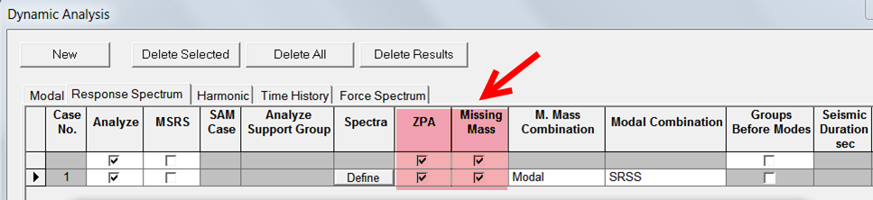

Should ZPA be applied when performing a Dynamic analysis with AutoPIPE?
When performing a Dynamic response spectrum analysis it is recommended to select "ZPA" option to capture maximum static or dynamic results. Also, Select "Missing Mass" to Capture additional Modal Mass beyond the Cut-Off Frequency.
Dynamic "Response Spectrum" Analysis
