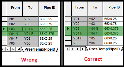

Answer #3
The soil name is changes at a bend's Near node point.
Solution: Soil property name should be the same around a bend or changes name only at the elbow's Far node point.
