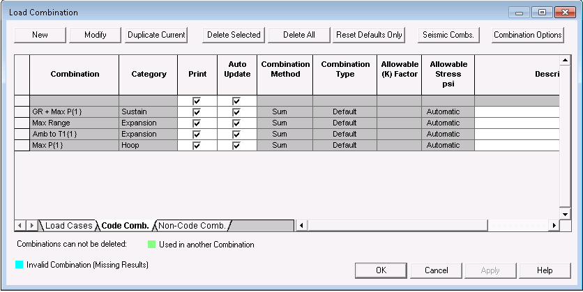

1) For code B31.1 2007 (Default load combination created by Autopipe)
Effect of pressure is included in Sustained load case.

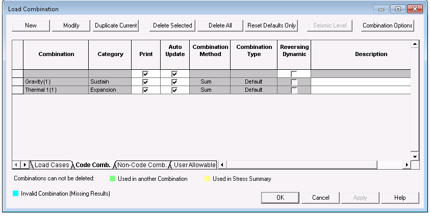

2) For code ND 2007 (Default load combination created by Autopipe)
Q. Why sustained load doesn't include pressure load?
ASME Nuclear default code combinations are always a single load case combinations because the Nuclear codes follows a different program path, the concept of Stress Summaries. Through Stress Summaries the program internally takes care of the pressure term using the correct value (i.e. Design Pressure or Load Case Pressure P01..Pn) in the respective Service Level set of equations. The stress summary reports the details and results about each equation (ex. 8, 9 10 ets.).

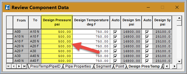

1. Stresses Due to Sustained Loads (Equation 8).
See AutoPIPE help for the detailed equation, note that the "P" value in this equation represents Internal Design Pressure. This Design Pressure value would be taken from the respective node point on the "Design Press/Temp" tab of the input grids. .

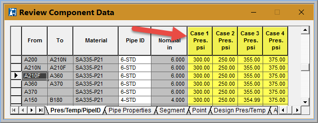

2. ND - Stresses Due to Occasional Loads (Equation 9)
Where as this equation calls for Pmax. This value is taken as the maximum value across all pressure load cases  P01.Pn from "Pressure/ Temp/Pipe ID" tab of the input grid.

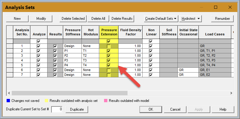

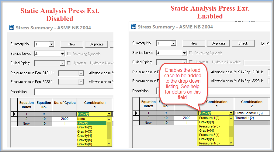

3. Disable / Enable Pressure Extension under Static Analysis sets:
Stress summary:
