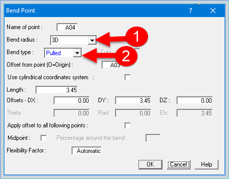

Piping Code = ASME NB, NC, or ND:
Using AutoPIPE Nuclear version, with piping codes ASME NB, NC, or ND, suggest that the proper Bend radius value be entered or selected from the drop down listing (ex. select 3D) and set Bend Type = Pulled (ex. select Pulled).
insert valve 2 feet (609.6mm) away on both ends.

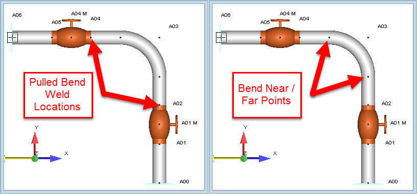

Question: Where to insert the Bend Weld Indices? at the valve locations or the Bend Near & Far node points?
Answer: at the Pulled bend weld locations. In this example, that would be at the valves.

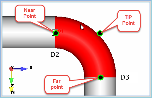

Remember that a bend is made up of 4 node points: 1. Near, 2. Far, 3. TIP, 4. Midpoint
The Bend's Near and Far points  are located based on the tangential distance for the specified radius to fit between intersecting lines. These points just so happens to coincide with standard practice for construction of a bend fitting to industry standards (ex. ASME B16. 9) for Short, Long, and xD bends. However a Pulled bend has legs on both sides that are typically much longer than a normal bend. Therefore, Pulled Bend weld indices should be placed at the actual weld locations, in this example, near the valve. The bend's Near and Far node points would be considered Straight pipe, i.e. no welds.
