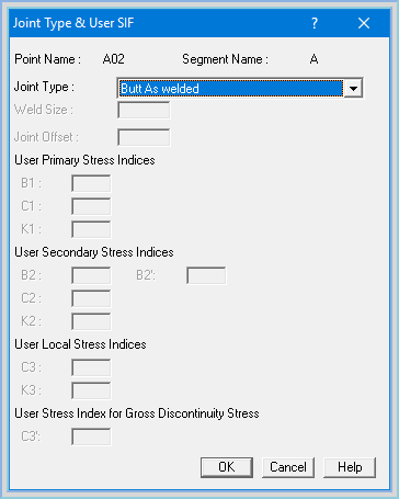

How to specify user stress indices to apply to only one end of a bend?
Using a nuclear piping code selected (i.e.  ASME NB, NC, or ND), select the bend's Near or Far point then select
Insert> Xtra Data> Joint Type and User SIF>. When the dialog appears, select the proper joint type or select User to enter all the indices values. press OK button when completed.
