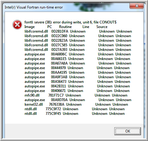

The following occurs when using AutoPIPE V8i analyze all with hanger selection:
Intel(r) Visual Fortran run-time error
Forrtl: severe (38): error during write, unit 6, file CONOUT$
If a model has hanger supports and it also reports warnings during analysis then program may crash when "Analyze > Analyze All..." operation is executed with "Select analyses automatically " option selected.
Workaround for the issue is
- Run hanger analysis separately (Analyze > Hanger Selection…)
- Uncheck “Hanger Selection” on analyze all dialog.
The issue is repeatable but is very tricky.
- Reproduce only when analyze all operation is performed with
- If sum of following exceeds 63
This issue was logged under TFS-D123863: "Analyze All" operation causes program crash on models having hanger support and some analysis warnings.
This will be fixed in a future release of the application.
