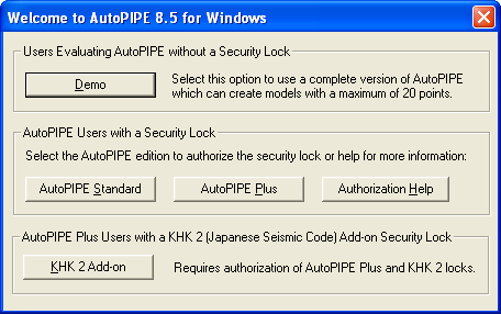

Start the AutoPIPE application
Step 1: Select the AutoPIPE program icon from:
Start> Program> AutoPIPE> AutoPIPE for Windows
Step 2: The Welcome to AutoPIPE screen will appear.
Step 3: Depending on your Select SERVER contract; Press AutoPIPE Standard or AutoPIPE Plus button.
Step 4: If licensing was correctly installed, the application is now checking for an available license. If a valid license has been located, the “Welcome to AutoPIPE” screen disappears and the application is ready for use.
Verify by inspecting the top of the application bar. The specified design code should appear in the applications bar at the top of the application window.

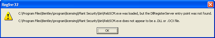

    9. If error screen appears as before (Error 1911 or 1905), use following procedure to register the RebSCM.exe.
      1. Locate the file RebSCM.exe
        File should be found under:
         “C:\Program Files\Bentley\program\licensing\Plant Security\bin\ RebSCM.exe”
      2. Select Start> Run> type the following on the cmd line:
        Regsvr32 pathname
        example: Regsvr32 "C:\Program Files\Bentley\program\licensing\Plant Security\bin\RebSCM.exe" (must use “”)
      3. The following screen appears, Press OK button.
