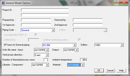

1. Start Autopipe, and create a new model.
2. Under General Model options:
a. Piping code = General
b. Pipe code to calc SIF = BS 806

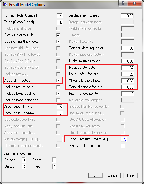

3. ANALYSIS OPTIONS
Suggest the following options under Tools> Model Options > Result ,
A. Direct Shear (N/R/A) = A (CSA-Z662 and BS8010)
Note: Autopipe always considers axial and torsional stress for the General piping code and to add Direct shear stress for codes abov
B. Total stress(Oct/Max)" = O,  Von Mises is required for the British code BS8010 i.e equivalent stress and CSA-Z662

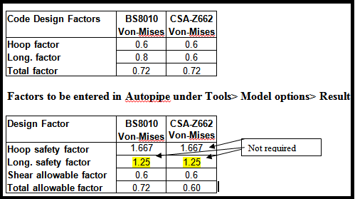

C. Shear Stress :
         Offshore codes do not have allowable for shear stress only. Default = 0.6
i. BS8010:1993 - Torsional + Direct Shear (Tangential)
ii. CSA-Z662: 1999 - Torsional + Direct Shear (Tangential shear).
Note: Torsional stress cannot be disabled for General pipe code hence is always consider.
D. Hoop Safety Factor, Long Safey Factor, Shear Allow.Total Allow.
Notes:
        1. Shear
               stress ignored in code compliance report
        2. BS8010 and CSA-Z662  – ignore longitudinal stresses
        3. Design factors shown are for Riser and hence Seabed pipeline stresses will conservatively have the same design factor as the riser.
        4. CSA-Z662 will use SIF factors from section 4.0 in calculation of longitudinal stresses although not explicit in the code which is conservative and consistent with other codes.
        5. Under Result Options dialog, “Use Nominal thickness” = checked for all piping codes which is used for all stresses.

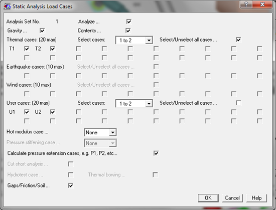

4. ANALYSIS
The following typical load cases are analyzed. Where U1 and U2 and two wave cases  and T1 - Tx is thermal case.
NOTE: Pressure analysis is considered since offshore piping systems can have very high pressure e.g 2000 psi

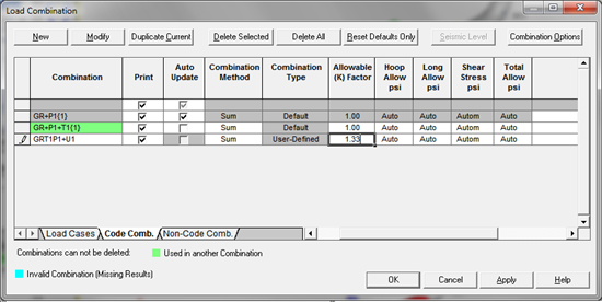

5. LOAD COMBINATIONS:
Where GR+P1 and GRT1P1 are functional load combinations and GRT1P1+U1 is a functional + environmental load combination under the occasional category with K-factor = 1.33 (Tools> Combinations> .
Note: under Tools> Model Options> Result Options dialog,  "Apply all K-factors" = checked  ON (see  image above).

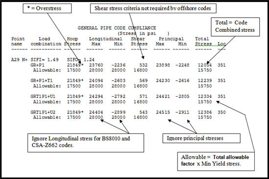

6. RESULTS
Notes:
    1. Ignore Maximum Shear Stress Ratio the System Summary report
    2. The allowable stress  for the CSA-Z662 functional + environmental load combination e.g GrT1P1+U1 will be based on the conservative riser value of 0.60 for functional load combinations therefore if any overstress in the functional + environmental load combinations manually assess if acceptable by multiplying the allowable by 0.8/0.6 (riser) = 1.33 or 1.0/0.6 for seabed piping using Pre-Autopipe 6.3 versions.
    3. In Autopipe v6.3 , under Result Options dialog  "Apply all K-factors" = checked and define functional + environmental combinations as shown in Load combinations section above.
