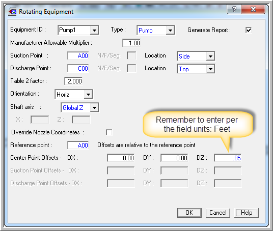

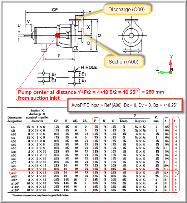

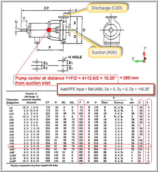

Question:
On the rotating dialog screen what is meant by Reference point and Dx, Dy, Dz values?
Answer:
From the online help:
Specify the global offset values DX, DY, and DZ from the reference point to define the location of the center point of the pump. Since AutoPIPE cannot display a point for the center of the pump, the pump center is defined relative to the suction nozzle or discharge nozzle.
Example: ANSI 4x3 (A40)

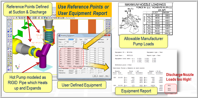

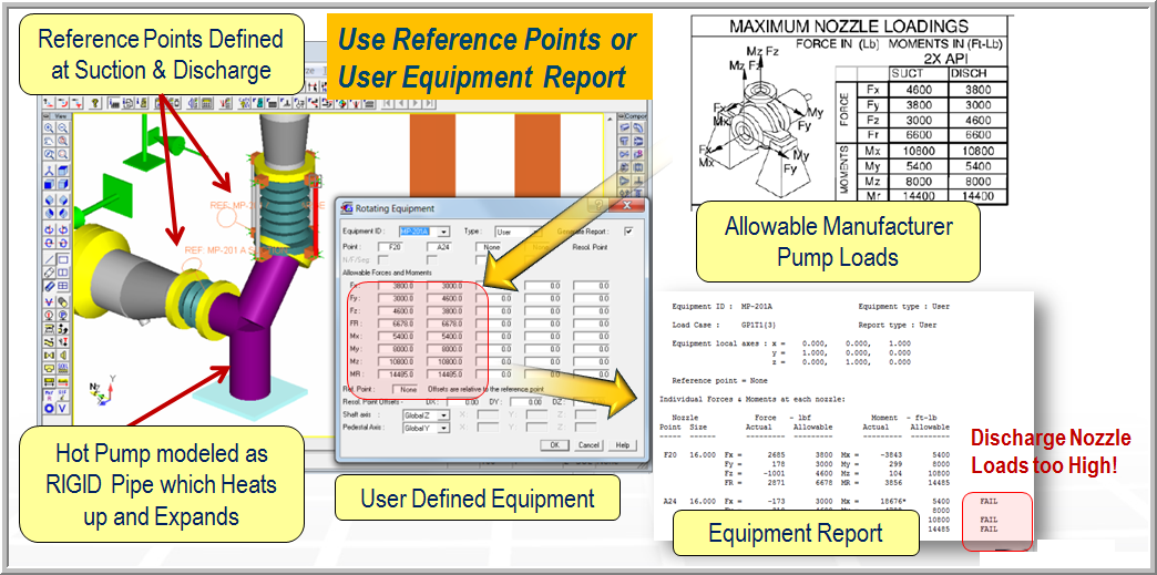

First we should model the Hot Pump as RIGID Pipe (shown as purple in image below) which Heats up and Expands
We can use either Reference points and/or User equipment to check the pump loads
Reference Points are Defined at the Suction & Discharge nozzles
In this example we have a special manufacturer pump with allowable loads defined in User Rotating equipment
The rotating equipment report checks all load combinations and reports nozzle loads. In this example the loads exceed the recommended allowables and FAIL is placed to the right of failed value in the report, as indicated in red below.
