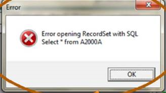

The following message appears when entering the design temperature:
Warning
Error opening RecordSet with SQL
Select * from A2000A
OK
How to avoid this from happening?
The message provides a clue to the problem encountered. "Error in opening RecordSet"... is hinting to an issue with opening a database file that contains various records. The only database files used in AutoPIPE Nozzle are related to Material files. Therefore, there is an issue with one or more of the 4 material database files installed by AutoPIPE Nozzle. Also, if there is a user defined material database file, the specific file may be missing or corrupted.

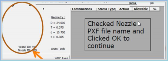

In addition with the error message, it was noted that the vessel nozzle image was missing:
This issue has only been reported one time and was directly related to a missing file(s) from the installation folder and computer permissions at the time when the software was installed.
Avoidance:
- User must have AutoPIPE Advance or AutoPIPE Nuclear Licensing available.
- Delete existing exported PXF from AutoPIPE.
- Uninstalled AutoPIPE and AutoPIPE Nozzle from the computer.
- Reboot the computer,
- Log into the computer with Administrative permissions (must have Admin role).
- Install old AutoPIPE - AutoPIPE Nozzle - New AutoPIPE software as mentioned here.
- Open Folder -
- C:\Program Files (x86)\Bentley\AutoPIPE Nozzle
- Verify the following 4 files are present:
- khkmatlib.mdb
- jismatlib.mdb
- asme2009.mdb
- asme2000.mdb
- Note: Copy any user generated material libraries to this folder
- If not, ask co-worker / Technical Support to provide these files.
- Copy the files to the folder mentioned above.
- Again, Reboot the computer.
- Exporting nozzle loads from AutoPIPE to AutoPIPE Nozzle again.
- The problem should now be fixed.
