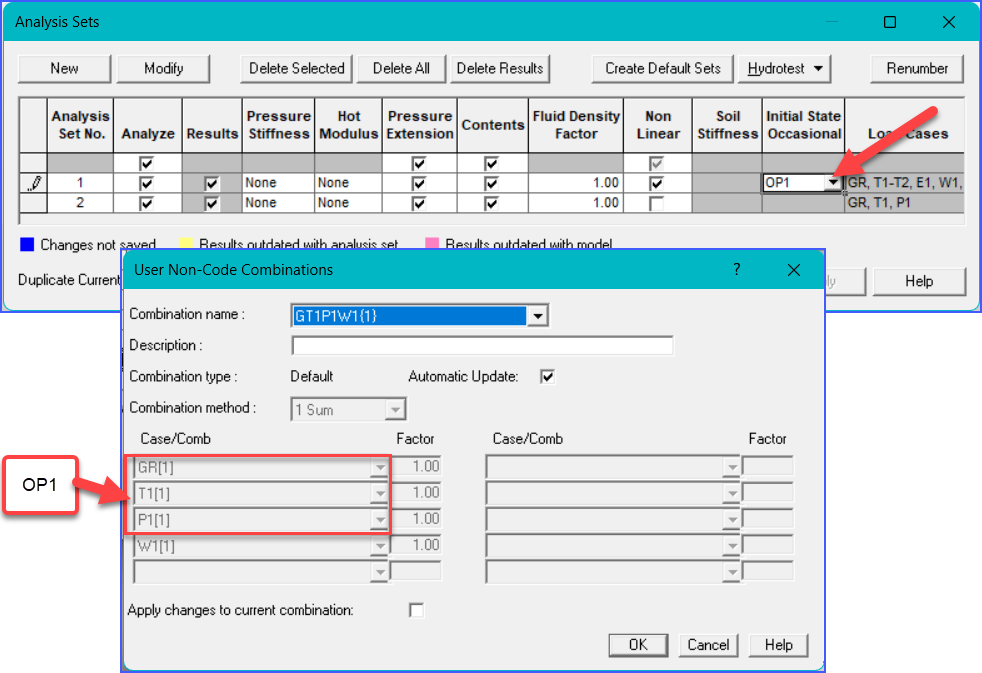

Note that both L1 and L2 are operating conditions, and L4 is caesar's superposition method of adding load vectors to achieve an individual load case T1. Whereas in AutoPIPE, T1 is an individual load case added in a load sequence to correctly calculate the operating conditions.
Furthermore, understand that caesar needs intermediate equations like L3 to calculate equations like L5 - hot sustained. However, as you now know AutoPIPE load sequence approach does not need intermediate equations like that found in caesar. Thus reducing the complexity of load combinations and length of output report.

If one must compare an AutoPIPE model with caesar, highly recommend comparing true operating conditions (ex. L1 to GRT1P1, L2 to GR+MaxP) instead of all the individual load case (ex. L3 &  L4 to T1) as the fundamental different approach of adding vectors / load cases use by the two programs may present dissimilar results for individual load cases and respective combinations where such individual load cases are used.
One final note, be sure check that all of AutoPIPE's Tools> Model Options> General, Edit, & Results settings match caesar's settings.

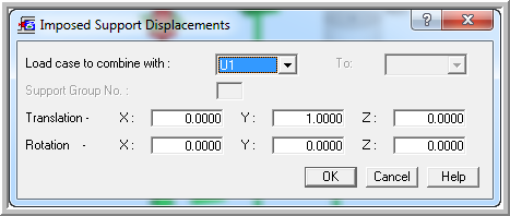

CAESAR has a ‘D1’ load variable which represents the inclusion of a user-specified displacement….does AutoPIPE incorporate something similar?
Answer:
Yes, Insert> Xtra-Data> Imposed Support Displacement, see online help for complete details on this AutoPIPE option.
As mentioned in the AutoPIPE's help and apparent on the dialog screen, an imposed support displacement can be assigned to any number of load cases (GR, T1-T100, E1-E10, W1-W10, P1-P100, U1-U140, S1-S10) or configured to span a selection of load cases. When that load case is used in a code / non-code combination, the specified imposed support displacement will be taken into consideration accordingly.
Example, the following support displacement is applied to load case U1, and will only be applied when load case U1 is included in a combination.

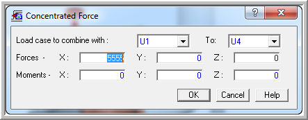

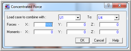

Caesar has a ‘F1’ load variable which represents the inclusion of a user-specified external force…does AutoPIPE incorporate something similar?
Answer:
Yes, Insert> Xtra-Data> Concentrated Force, see AutoPIPE's help for complete details on this option.
As mentioned in the AutoPIPE's help and apparent on the dialog screen, an concentrated force can be assigned to any number of load cases (GR, T1-T100, E1-E10, W1-W10, P1-P100, U1-U140) or configured to span a selection of load cases. When that load case is used in a code / non-code combination, the specified concentrated force will be applied accordingly.
Example, the following concentrated force is applied to load cases U1-U4, and will only be applied when U1, U2, U3, or U4 is included in a combination.

Initial load to Occ = Gr
E1(1)
Load dues to occasional Earthquake 1 load case for load set 1 after all the initial GR load has been sequenced.
Individual load case Static Earthquake
U1
Initial load to Occ = Op1 (GrP1T1)
W1(1)
Load due to occasional Wind 1 load case for load set 1 after all the initial loads, Gr> P1> T1) have been sequenced.

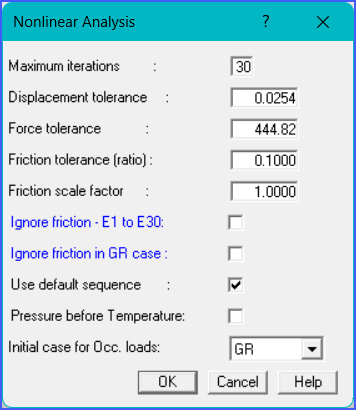

AUTOPIPE is performing analyses for load increments.
It is important to note that in an AUTOPIPE analysis, each load case is an increment of load, not a total load.
For a linear analysis, the results for each load case are obtained all at once. By linear analysis, the   “Gaps/Friction/Soil" option has to be disabled.
For a nonlinear analysis the results are obtained sequentially.

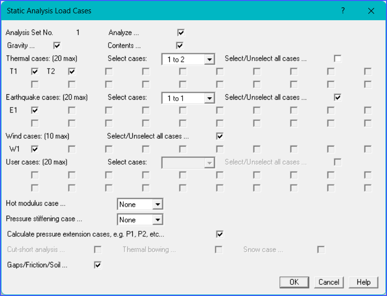

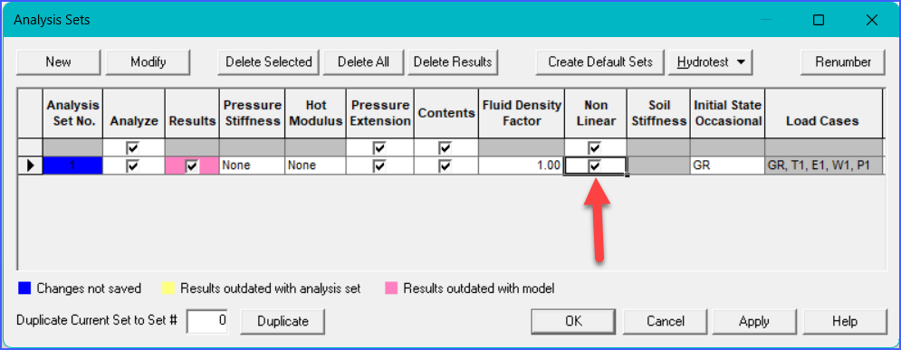

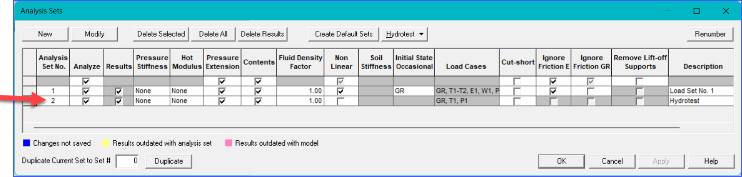

The “Static analysis set” is set under Static Analysis Sets (Analysis > Setup > Static Analysis Sets)
Analysis set options “Ignore Friction E” and “Ignore Friction GR” have to be removed because by caesar the friction is always acting
First the analysis has to be done for the code stresses and once it is done, you can create your own non-code combinations.
It is used to create your operating case or compare some loading case to define the maximum forces and moments on nozzles from the equipment.
By AUTOPIPE , The code combinations are done automatically and users can define as many analysis set as we want and combine the results as needed.
For instance, the hydrotest is a linear analysis so that we can define a 2nd analysis set to define this case.
AutoPIPE has to define operating 1 + Wind1 by the non-code combination to define the maximum forces and moments on supports.

To obtain non linear analysis in Caesar II, you have always to create a loading case operating, then operating + wind or +earthquake, then subtract the operating + wind or + earthquake from operating alone.
Then this occasional load will be added to the sustained stresses and compare to 1.33 Sh for instance by ASME B31.3
