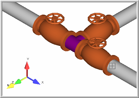

Inputting three way valves in AutoPIPE is a bit convoluted at this time. AutoPIPE does not allow users to branch from a valve, see the following procedure:
Start modeling from center connection point of the valve:
    1. Start from the connection point, insert a small pipe run (ex. 1 inch)
    2. Insert a valveI, nsert pipe run for actual connected piping to the valve continue modeling piping system.
      1. Length = "measure from the center of the valve to the actual pipe connection" - "small pipe run in step A"
      2. Weight = 1/3 of the total valve weight from manufacture literature
    3.
    4. Select the small pipe run from Step A, and Insert> Rigid Properties over Range> do not enable "Include weight" check-box, but check ON "Include Thermal Expansion" check-box
    5. Make the origin point of the small run the current node point, repeat steps A and D to create the other two legs.
      Note: before adding the 3rd leg, recommend to convert the intersecting junction point to a Tee using the "convert run to tee" icon / button. and then add 3rd leg. See image below for finish modeling approach.
Insert 3-way valve on existing pipe run header
    1. At the end of a pipe run Insert a valve. Insert a small pipe run (ex. 1 inch).
      1. Length = "measure from the center of the valve to the actual pipe connection" - "small pipe run in step B"
    2.
    3. Insert another small pipe run same as above (ex. 1 inch).
    4. Insert another valve with the same properties as above, Step A.
    5. Select both small pipe runs from Step B & C, and Insert> Rigid Properties over Range> do not enable "Include weight" check-box, but check ON "Include Thermal Expansion" check-box
    6. Make the node point shard by both small runs from Step B and C the current node point, convert the intersecting junction point to a Tee using the "convert run to tee" icon / button.
    7. On the branch of the Tee, add 3rd short pipe run and valve with same properties as above.
