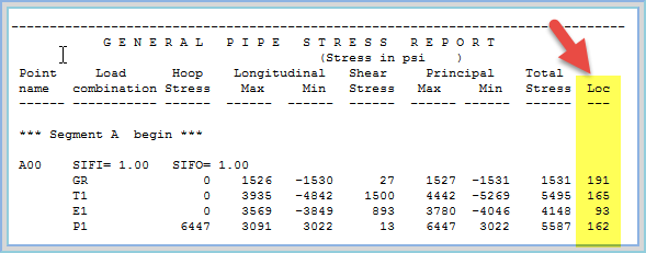

What does LOC mean in the General Stress Report?
Total stress is calculated every 15 deg and the zero degree axis for the total stress location angle in a clockwise direction around the pipe. The 0 degree axis is the local axis of the pipe cross-section, i.e. perpendicular to the pipe axis, corresponding to the resultant in-plane bending moment.
For example, if the local bending moments are my and mz, then arctan (my/mz) is the location off the 0 degree reference axis for the general stress location relative to the local y axis.
Note: For straight pipe in-plane bending is arbitrary since no plane of bending like an elbow.
Axial stress: fx/A
in-plane bending stress: my/Z
out-plane bending stress: mz/Z
where,
fx = local axial force
my = local in-plane bending moment
mz = local out-plane bending moment

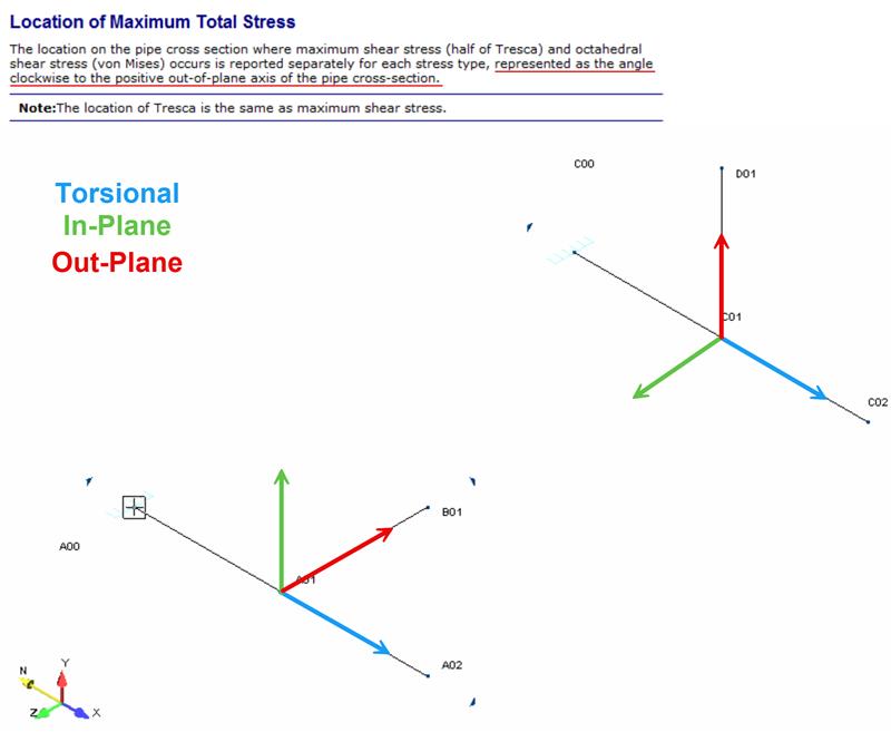

Question: 3. For tee points, AutoPIPE v25 measures the LOC's angle datum from the branch axis, while AutoPIPE v12 uses the local Y-axis as the reference.
Is this update related to correctly accounting for ii (in-plane SIF) and io (out-of-plane SIF) in the transformed moments (My, Mz) before calculating the angle via arctan(My/Mz)?
Answer: This is an Enhancement:1235552 implemented in version 2023.1, the software changed how it defines the local coordinate system for tee junctions in piping.
A tee has three legs, and the software now creates a special coordinate system based on how that tee is actually positioned in space. Here’s how it works:
    1. Torsional axis (Twist direction)
      This axis is along the direction of the pipe leg.
    2. In‑plane axis (Flat direction)
      This is in direction normal to the plane the junction resides on.
    3. Out‑of‑plane axis (Up direction)
      This axis is created by crossing the first two axes.
LOC's angular datum is aligned to the positive out-of-plane axis. Since the tee local coordinate system is strictly dependent on the orientation and geometry of the tee, the LOC is expected to change. See the image below for a visualization.
So, the differences you're seeing are expected — the coordinate system is now smarter and reacts to how the tee is actually arranged.
