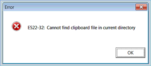

E522-32: Cannot find clipboard file in current directory message appears in AutoPIPE
Product(s): AutoPIPE
Version(s): ALL;
Area: Import
Date Logged
& Current Version
July. 2017
11.00.00.22
The following appears when importing a model into AutoPIPE:
Error
 E522-33:  Cannot find the clipboard file in current directory
OK
Why and how to avoid it?
User should be able to Import ACAD/MSTN/Global Coordinates into program. There is a known issue that was logged under:
Defect 370841:Unable to Import ACAD/MSTN/Global Coordinates
This was first found in 09.06.xx, however was fixed in 10.01.xx.xx and higher.
Avoidance:
Copy AutoPIPE folder to some non Program File x86 folder.
