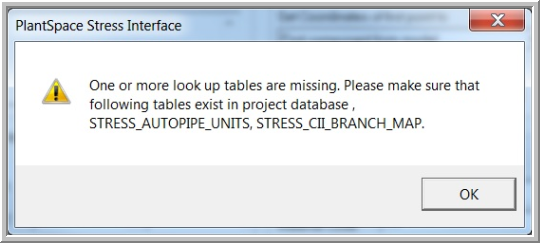

When Exporting a model from PlantSPACE Stress Interface an message about making sure tables exist is displayed before creating the AutoPIPE NTL file, shown below:
One or more lookup table are missing. Please be sure that following tables exist in project database,
STRESS_AUTOPIPE_UNITS, STRESS_CII_BRANCH_MAP
OK

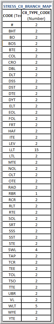

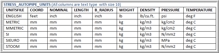

Why and How to avoid?
According to the PlantSPACE team, they suggested that the user review the administrators guide for instructions to rebuild the database..
There are two essential tables stress_autopipe_units and stress_cii_branch_map. You may need to create these tables in the database, should be part of the example project:
