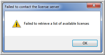

The following appears after starting LMT or when working in LMT
Failed to contact the license server
Failed to retrieve a list of available licenses
OK
Why and how to fix it?

One or more of the following may be affecting why the above message is being displayed.
1. As mentioned in the message, the LMT has failed to connect with the Hosted / Deployed SELECTserver. Typical reasons are:
2. You were removed from the list of authorized people able to use a specified Server Name and Site Activation Key after you had already signed up.
3. Something happen to your Server Name / Site Activation key settings in LMT.
4. Your internet connection has failed.
5. The Hosted has been disconnected for maintenance reasons

6. For Deployed SELECTservers, typically your company IT department is in charge of the SELECTserver location and technical support. These servers can have intermittent outages that are beyond Bentley's control. In addition, the Deplyed SELECTserver could have been moved to a different location where the Tools> Options> SELECTserver Name setting may need to be updated. Please contact your Bentley On-site admin.
7. Your contract or training license has expired.
Step #1: Check your internet connection to be sure that you computer can ping the internet or ping the Deployed SELECTserver location.
Step #2: Contact your Bentley On-Site Admin, who can:
a. Confirm your Server Name and Site Activation Key.
b. Look at the SELECTserver for Checkout / Product Restrictions
c. Follow up to see if the Hosted Server is down.
Step #3: Nothing can be done in LMT with the specified Server Name and Site Activation until F9 command can be completed without displaying the failed dialog screen above.
