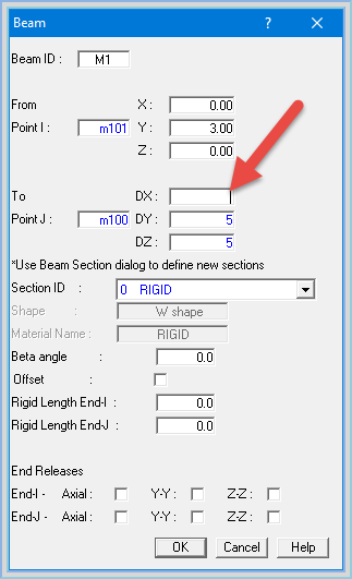

When importing a AutoPIPE dat file into another model where both files have beams, beam error occurred, why?
Insert / Open model,  Beams connected to bends / valves are incorrectly entered. Beams may have empty Node i or Node j : Enter a valid Node name on Beam input grid for all Beam ID's
Note, that DX is blank, input a valid value.
The following has been logged: CAE-TR-11077
