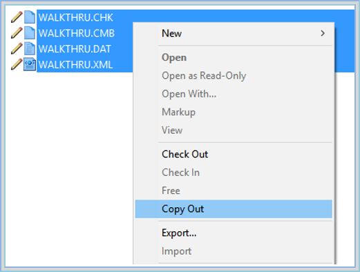

  1. Copy out all the files in a local folder which are on ProjectWise server but not linked:

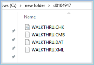

  2. Go to the local workspace folder and ensure the files have been downloaded

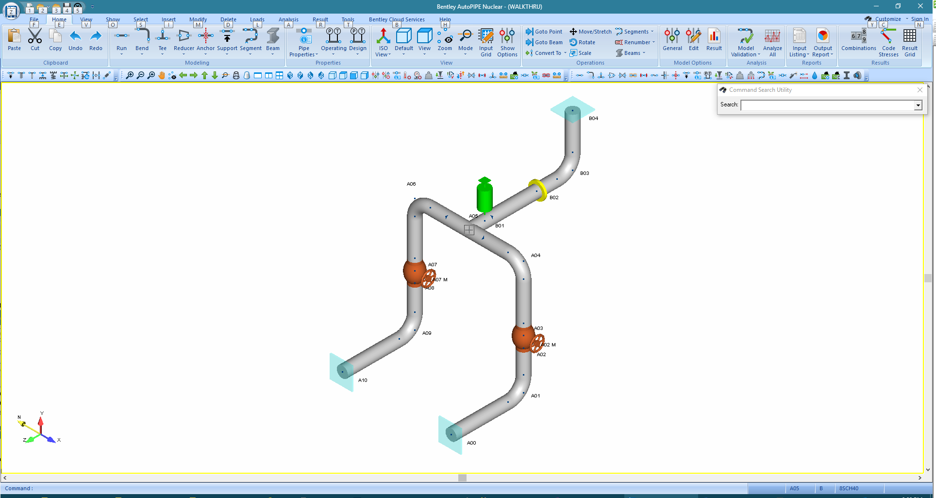

  3. Open the model in AutoPIPE

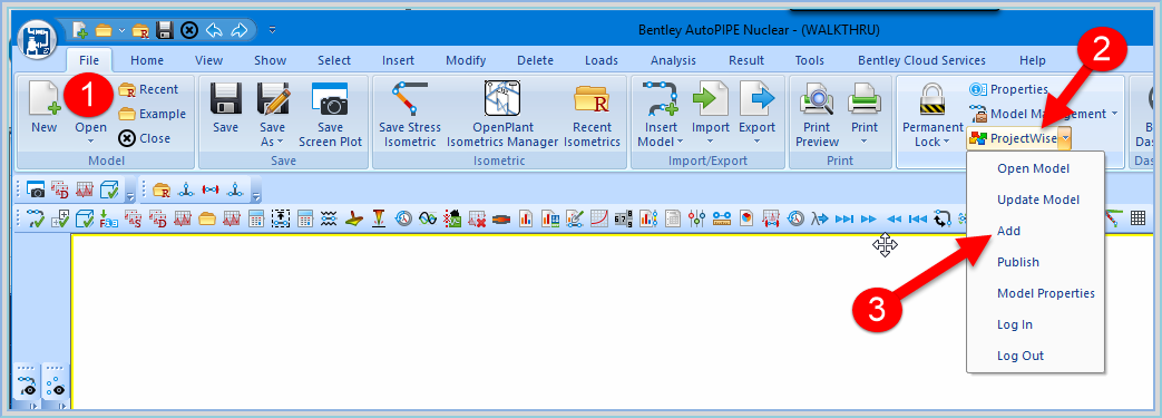

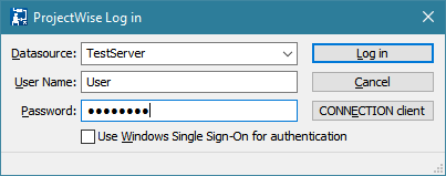

  5. From ProjectWise Menu (File->ProjectWise) or Application Button->ProjectWise, select ‘Add’ option.
  6. Provide Login credentials if not already signed-in
  7. Select the appropriate folder on ProjectWise dialog for saving the model.

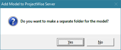

  8. Also Click Yes for creating a separate folder for the model (Recommended). If this files to be added on the server are already existing, the document set relation will not be created.

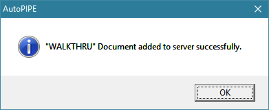

  9. Program will give a confirmation message on completion:

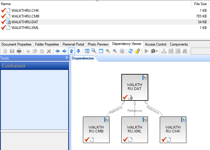

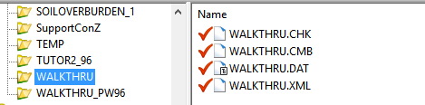

  10. Confirm the update using ProjectWise Explorer and note that only the supported file types would be uploaded to the server.
  11. Click on the Walkthru.dat file (Please note a tree icon on the file)
  12. In the dependency tab, a full file structure would be shown, describing the associated files.
