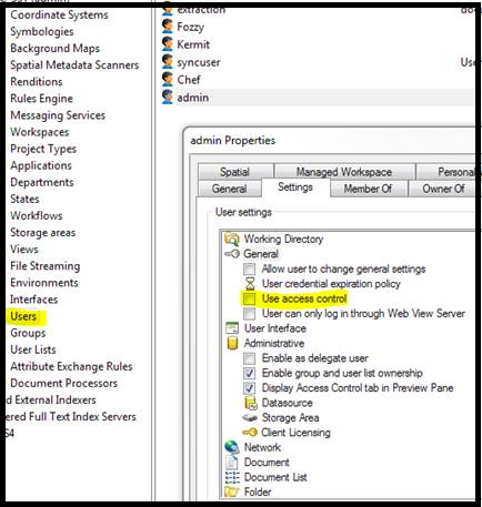

Why can an AutoPIPE model not be saved to ProjectWise folder?
Had already confirmed ProjectWise settings and user rights to save files to a specific folder
As a test of security access to ProjectWise, ask on-site ProjectWise Admin to temporarily turn off "Use Access Control" setting for the user logged into ProjectWise.  In the screen shot below from ProjectWise Administrator, disable / uncheck "Use Access Control" setting.
If that can not be turn off, see if the user is able to make a document in the folder that was created by logging into ProjectWise Explorer, right clicking in the folder and choosing New> Document.
If it prompts for a wizard, choose no wizard and give the file a name.  If they can successfully create the document in that folder, then it is proven not to be a permissions related issue.
If they can't create the document and get an error, then ask the ProjectWise Admin to resolve the permission settings for that user in that project / folder.
Interface bewteen Projectwise and AutoPIPE
