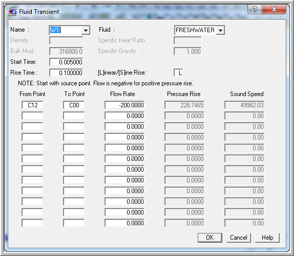

02u. "Fluid Transient" - AutoPIPE Load Case
Comments, Questions, and Answers related to AutoPIPE's "Fluid Transient" Dialog screen

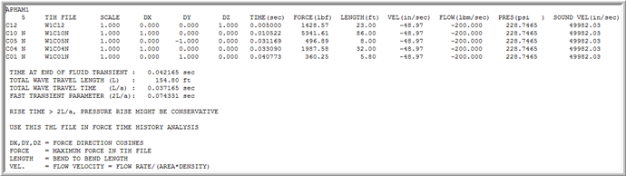

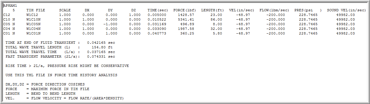

Pressing OK button closes the dialog and the following report is displayed about the transient. This file is saved in the same folder as the model (example: W1.THL):

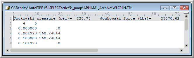

In addition, the fluid transient utility automatically creates the relevant force-time histories (*.TIH) and can handle either a positive or negative shock wave at each point listed in the *.THL file, see example below (W1C01N.TIH):
Note:
1. TIH files are always in English units regardless of the Model units file specified on the General Options dialog screen. To see the unit conversion factor used, open the respective Units file (ex. SI.UNT) in any text editor (i.e. Notepad), and locate "Force" in the right column, read to the left for the factor conversion value to English units. See the following WIKI here for more details.
