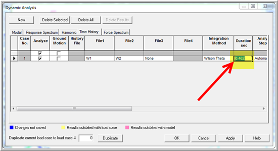

What value would be entered into the Time history dialog screen for "Duration"?

For those time sensitive people, as mentioned in step #11 of the Executing Water hammer (time history) example document,  "Duration"  =  0.443 (First period, 0.384 sec, plus water hammer duration 0.059 sec),

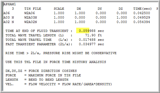

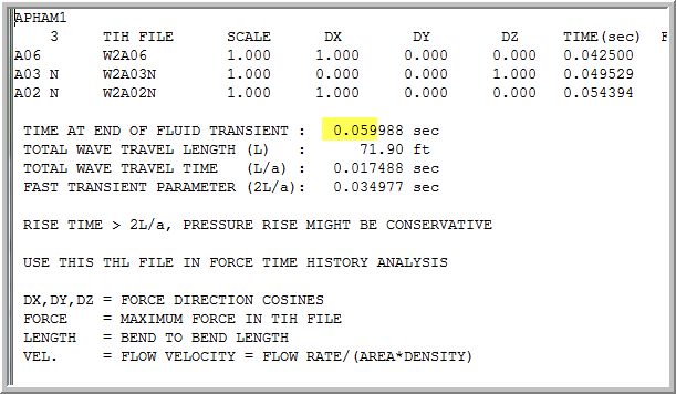

a: Water hammer duration value 0.059 sec comes from the THL file:

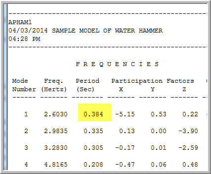

B. First period 0.384 sec comes from the Frequency output report

Yes, the duration should include the total time of the transient + first mode.
Locate the highest time value found in 1 of 4  *.THL files; under "TIME AT END OF FLUID TRANSIENT". Add to this "time of the first period from Frequency report" as outlined above.
