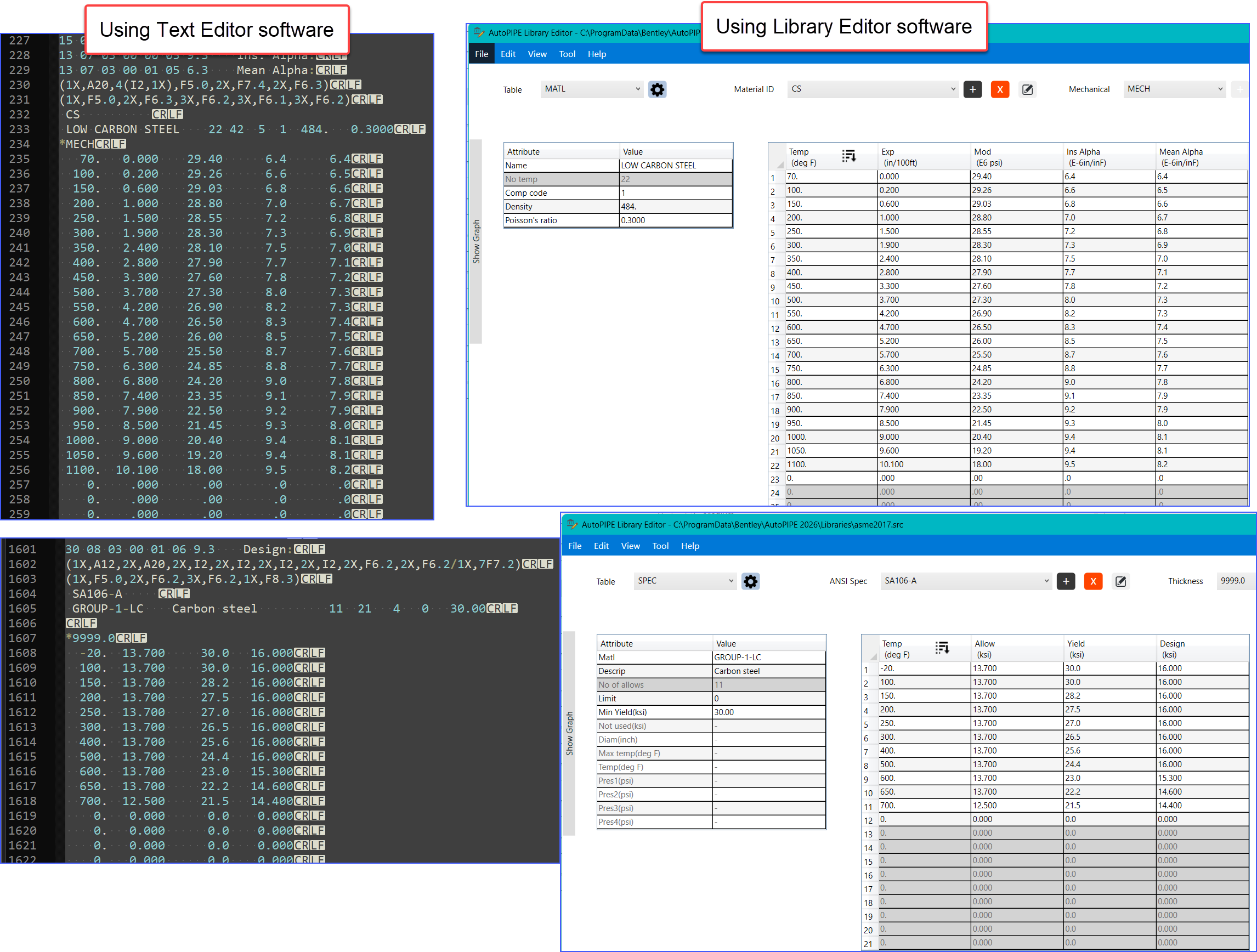

SRC files are ASCII text-based files that follow a specific AutoPIPE library format for a particular piping code. SRC files can be opened by either AutoPIPE's library editor or any text editor.
Note: Strongly advise to open an *.SRC files using AutoPIPE's Library editor. The editor prevents many of the common mistakes by users when editing the file using a text editor, comparison below:

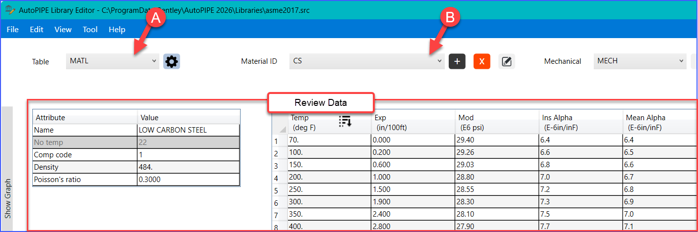

    4. Select Tools> Library editor command
    5. Select File> Open> navigate to an SRC file location (default: C:\ProgramData\Bentley\AutoPIPE 20xx\Libraries)
    6. Search for and open a SRC file (ex. ASME 2017)
    7. After the file has been opened
      1.  Select item from drop down menu to choose a table type to be viewed:
        1. MATL: Properties shared for same type of material, ex CS: Carbon Steel
        2. SPEC: Specific Code Dependent Material, ex. SA106A
      2. Select Drop down listing for options per type of table selected above
        1.  (MATL table) - Complete listing of type of materials available in the library, ex. CI (Carbon Steel), ST (310 Stainless), etc
        2. (SPEC table) - Complete listing of Code Dependent materials available in the library, ex. SA106-A, SA312-TP321, etc

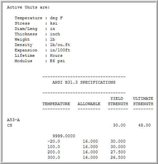

3. Select "Library name" = B313-06
If a model is opened, default setting will match the current General Model options material library. Otherwise, select a library name from the drop down listing.
4. Action = Scan.
Press OK button
5. AutoPIPE Viewer appears with the B313-06.lib Spec section, excerpt shown below:

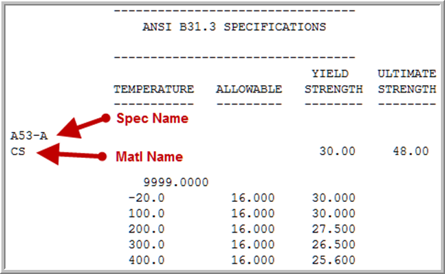

1. Above procedure is only the Specs part of the LIB file. Repeat using the same process but select a different Table type (ex. Material, Creep, etc..).
2. The Specification data is connected to the Material data by "Material Group" name, the name must be exactly as shown on the MATL table for the link to work.

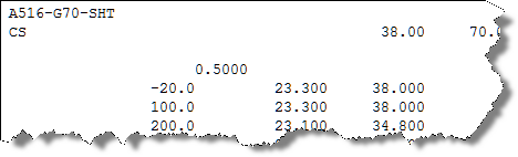

3. If a material has different values based upon Wall thickness, the material data will be separated as shown below:
Example: A516-G70-sht. material has different data for wall thickness < 0.5 inch, < 1.00 inch, <2.00 inch:
