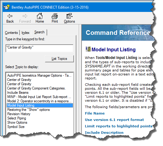

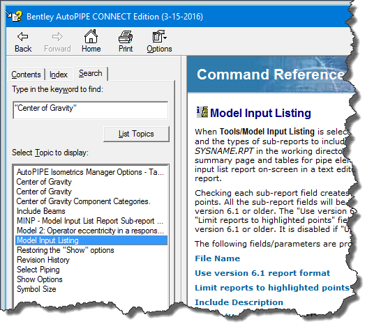

 How to create a Center of Gravity report in AutoPIPE?
Please see the following AutoPIPE help section:
Help > Contents> Search Tab> enter "Center of Gravity" (include the quotes), press List Topics button, double click on " Model Input Listing" from the selected topic list provided to see more information.
"Center of Gravity" summary is a sub-report to the "Model Input Listing" report.
Model input Listing - Center of Gravity sub-report
