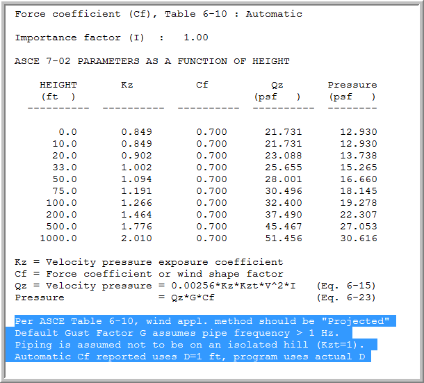

All things being equal in the model except for wind speed. Found that pipe code stresses from W1 speed = 100 mph are higher than stresses from W2  speed = 110 mph. It appears that the wind pressure is correct from the model listing file.
Is  there a problem with AutoPIPE calculations?
AutoPIPE is working correctly.
Caution when reviewing the Model Input listing "Load Summary" sub report for Wind 1 and Wind 2, see the foot note highlighted below:
For more details, please see the following explanation:
This is a boundary value problem, in which AutoPIPE will jump from using an automatic Cf (force coefficient) value of 1.2 down to 0.7. AutoPIPE only takes in to consideration diameter D and qz value when calculating automatic Cf. When D*SQRT(qz) > 2.5, AutoPIPE uses a value of 0.7, otherwise AutoPIPE will use a value of 1.2. This may result in decrease in wind forces around that boundary condition.
Please see the following AutoPIPE help section for complete details on this subject:
Help > Contents> Search Tab> enter "Force coefficient Cf (ASCE 7-02)" (include the quotes), press List Topics button, double click on the selected topic from the list provided to see more information.
Workaround:
Only perform this step if you do not accept using the CF = Automatic explanation above. Instead of using Cf = Automatic, enter a user defined value (ex. 0.7) to be used for all piping regardless of height and pipe diameter.
