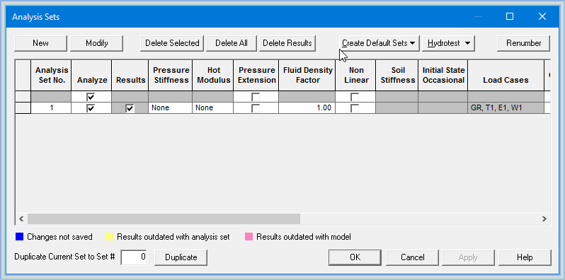

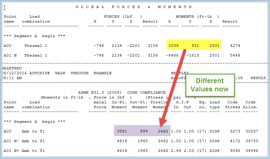

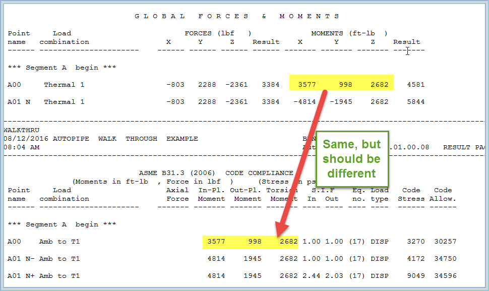

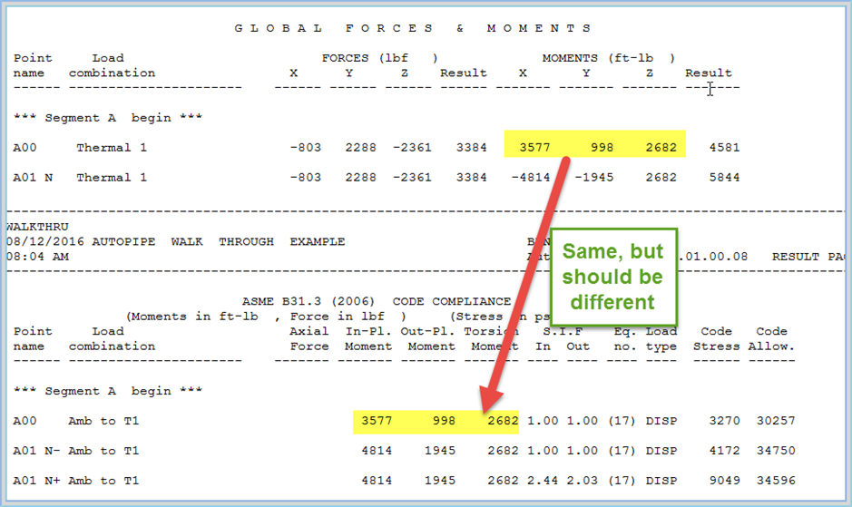

Does not appear that changing this "Apply modulus ratio" options makes any difference to the AutoPIPE's results..  i.e. moments have the same values, opposite to what is written in Help.
What needs to be done to have this option affect the results?

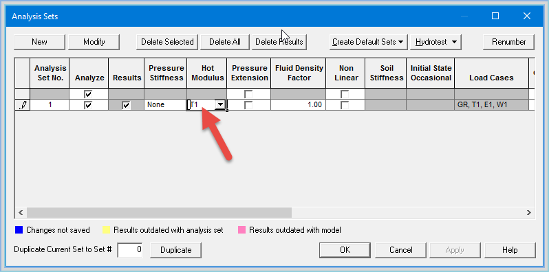

This Apply modulus ratio option works in conjunction with the Hot Modulus drop down int he Analysis Sets dialog. For each analysis set that is not assigned a hot modulus, this ratio will be 1.0
Again, to apply this  change user must set a Hot modulus for the analysis set:
