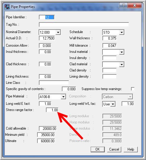

Non-nuclear piping codes does not have any elaborate fatigue calculations. However simple fatigue calculations for thermal cycles and harmonic loads can be done.
For thermal cycles, you can enter the "range reduction factor f" on the Pipe Properties dialog, shown below:
Note: place cursor in this field and press F1 keyboard button to see detailed information on this settings.
By default this factor is 1.0 and it does correspond to 7000 thermal cycles or 20 years of daily cycles. You can press F1 while in this field and will be able to see a table or equation for this factor as a function of number of cycles. This factor f appears in Equation (1a) and (1b) of ASME B31.3 and is also used in many other codes. If you have several operating temperatures, each with different number of cycles, then an equivalent number of cycles N can be calculated using Equation (1d) of ASME B31.3.
As for high cycle fatigue as is the case of vibrations caused by reciprocating equipment and is usually entered as harmonic H cases, the user is able to manually create a code case H1 and set allowable using Tools> Code combinations> user allowable stress. The allowable in this case is based on stress limit at the end of fatigue curve. For Carbon steel materials, the allowable is usually 12500 psi (0 to peak). For Austenitic stainless, the limit is 13600 psi at 1.0E+11 cycles. The user may want to divide this allowable stress by stress concentration factor for a butt weld.
