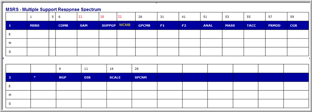

03. The online documentation from SelectSeries 4 09.05.00.21, for MSRS record shows the Batch Inpu
Product(s): AutoPIPE
Version(s): 2004, XM, V8i, CONNECT;
Area: Import / Export
  Date Logged
& Current Version
Feb. 2016
10.00.00.10
The online documentation from SelectSeries 4 09.05.00.21, for MSRS record shows the Batch Input MSRS command record layout appears to be wrong?
Answer:
The correct format of the card should be updated to following. Updates to first row: SAM, SUPPGP, MCMB. MCB was completely missing in the data table.
The fix should appear in AutoPIPE V8i 09.06.01.xx and higher.
