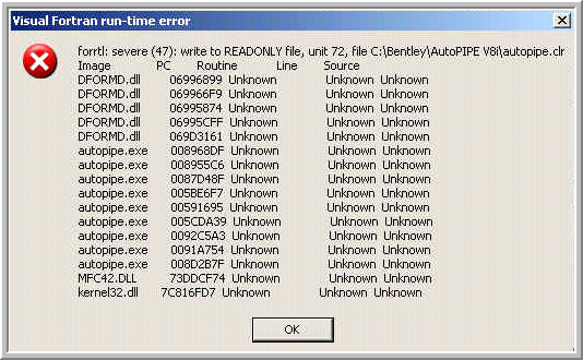

The following was displayed when starting the program:
Forrtl: severe (47): write to readonly file, unit 72, file C:\Bentley\AutoPIPE\AutoPIPE.clr
How to fix and avoid?
Answer:
Increase the user's computer rights to have read / write access to the folder located on C drive "C:\Bentley\PlantFLOW V8i". Then it will work.

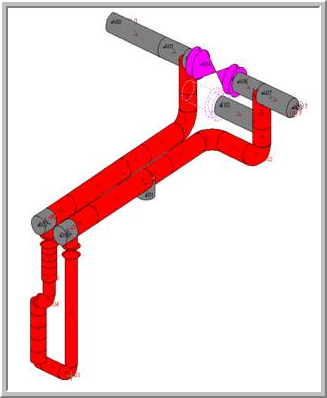

In a model of Pumps and heat exchangers in basement, control point in the suction side of the points, then up to the system with a return. the following is being displayed when analyzing the model:
* * * W A R N I N G - MODEL * * *
     W726-35: Inconsistent flow dirs at point K287
How to fix and avoid ?
Answer:
In this particular case:
The model had segments that start and stop at reducers, or have extra points at reducers ( i.e. L180 & L181). This confuse the direction of flow.
Suggested  that start / stop segments at run points instead of reducers and examine all reducers to have only 2 node points that continue in the same direction.
Also, review the model to be sure that all bends are correctly shown (i.e. no 90 deg sharp corners) . Suggest that each sharp corner is confirmed as an OK bend.
Model analysis was able to converge if T-losses were ignored and with increased iterations to 100.

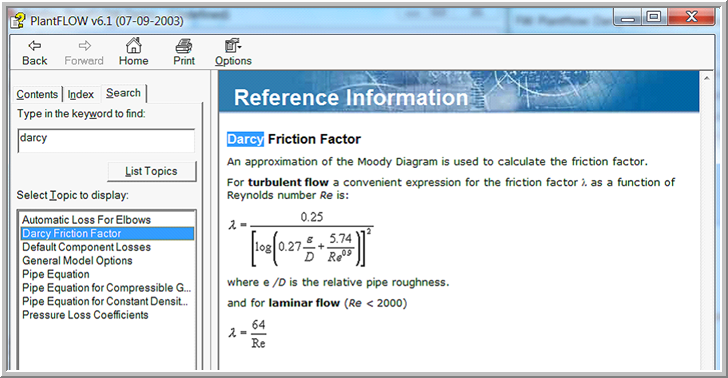

why isn't the Colebrook-White Equation used to calculate Darcy Friction Factor?
Answer
The online help shows the equation used.
 Darcy friction is an iterative equation. This equation is used to speed calculations and have the same accuracy as Colebrook-White equation. We have no complaints about this equation as it gives very good values compared to moody diagram (which is based on Colebook-White). In PlantFLOW we do not have transition flow. It is laminar Re < 2000, otherwise turbulent.
The reference for friction factor equation is :
 Miller, D.S., Internal Flow Systems. 2nd Edition, Gulf, 1990.

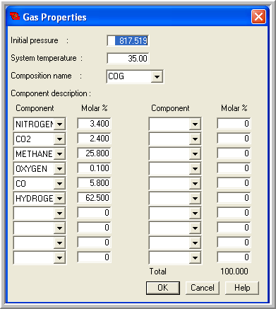

Gas Library. Their gas (COG) in this system includes the following composition. We’ve defined those in our Gas library, but not sure if it’s properly defined, especially we don’t know how to define CnHn 2.5%
Answer:
We do not know what CnHn stands for. Since this is a low percentage of 2.5%, suggest that is replaced with any gas that better matches its density. the development team suspects that n-pentane or n-Hexane would be a reasonable match. If you like to add this gas to the gas library you may do so in tools> library if you have the critical properties and conductivity values.
Item #16:

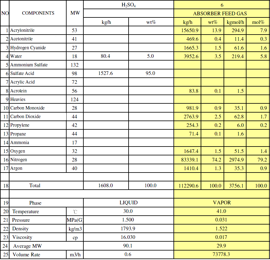

How can I build the air property with the attachment.(The yellow column in attachment)
Answer:
Unfortunately we do not have all the components of the mixture. For example the first two components are not part of AGA-8 or NIST.
There are two ways to do this.
Method #1:
User Pseudo gas as the fluid type and enter the MW, density and viscosity shown at the bottom. Some of the data is not shown and can be estimated by using AG8-8 (air) and checking model input listing as shown below. Add 0.1MPa to get absolute pressure (0.131 MPa).

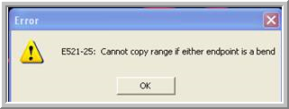

Can AutoPIPE/PlantFLOW create 0 length pipe sections ? This would be very useful for accommodating actions like copying from bend to bend sections, inserting user loss sections after tees etc
Answer:
At this time, both AutoPIPE and PlantFLOW has the following error message appear when you try to copy any range with the starting and/or end point is an as any point on and Elbow, (ie. Near, Mid, or Far), “E521-25 Cannot copy range if either endpoint is a bend”.
One possible workaround is temporarily converter from a bend to a run point.
Copy the selections set and the convert the elbow, turned run, back into an elbow. I will send your suggestion to the CAE development group, where it will be logged for enhancement consideration.
A 0 length run can be created at any elbow, but it is not advisable.  The program sometimes has difficulty calculating equations based on a 0 length node run. However if you must, place the cursor at the elbow tangent point, Insert run> Length = bend radius. Using the keyboard arrows, you could cycle from the bend tangent point to the near/far point. The next point should be the new run point you had just created. This point occupies the same space as the elbow point, thus creating a zero-length run.

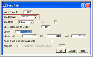

I enclose a simple model. In all my trial I do not seem to be able to properly fix a bend with a radius (standard short/long versions are not a problem). Could you possibly take a look at the *.FDA and let me know what I am doing wrong ?
Answer:
Select the one of the elbows and then > Modify > Bend, the following dialog box appears.:
The radius of the elbow can be changed by selecting short or long from the drop down box. Or, you could enter the actual elbow radius in the field, as shown above in red. You can enter a bend radius value up the distance from the bend point to the nearest node point, which occurs from either direction. To illustrate this point, open your model, delete run point A01, A03, A04. Now, Select > Bend A02> Modify> Bend> Enter 326 mm in the Bend radius field , press OK
Notice the elbow is drawn, but A02f is very close to A07. Select the bend again, change the Bend radius from 326 mm to 327 mm, now notice what occurs. An error screen appears and the elbow is not drawn correctly. Thus, the largest bend radius is 326 mm.

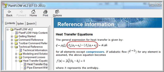

I had run a simulation on a steam piping model to analysis the temperature drop across the pipe. However, the results seem questionable. Thus, I did some manual calculations based on the heat transfer formula extracted from the software tutorial file and found that both results did not tally
Why?
Answer:
Heat transfer is also a function of the pressure drop. For smaller pipes there is more pressure drop and hence more discrepancy.
For example for 6” pipe when pipe roughness is decreased to 0.01mm Temperature  is changed from 7.8 to 4.6 and pressure drop from 700 to 331.
Unfortunately there is no way to set pressure drop to zero in this case. See P2 and P1 in the equation below.
Note: The term e refers to internal energy.

What Gases and Liquids are available in the library?
Answer:
Per the online help:
This contains the fluid data for specified fluids. Default is PLANTGAS for "Gas Library" fluid, PLANTLIQ for "Liquid Library" fluid and "NISTLIB" for NIST fluids. PLANTLIQ contains temperature dependent liquid properties. PLANTGAS contains gas components properties (Molecular weight, Critical Pressure, Critical temperature, Accentric factor and temperature dependent Cp values) for Peng-Robinson equation of state for gas mixtures.
Fluid Properties
PlantFLOW contains an extensive list of fluids such as AGA-8 equation of state for natural gas mixtures, NIST hydrocarbon gas or liquid mixtures, Peng Robinson equation of state gas mixture library, generic liquid library and ASME steam tables. Some of these fluids are limited to PlantFLOW plus.
The dialog parameters displayed when the Edit/Fluid Properties option is executed depends on the current Fluid Type defined for the model.
The Fluid Type may be assigned/modified via the Tools/Model Options/General command. When you assign or modify the Fluid Type for a model using the General Model Options dialog, another dialog will display to enable you to define the properties of the selected type. The properties of the currently assigned Fluid Type may be modified directly using the Edit/Fluid Properties command.
The fluid types are listed below.
Fluid Types- PlantFLOW Standard Version
AGA-8 Gas:
AGA-8 Equation of state for natural gas mixtures. It includes 20 different user specified gas components. PlantFLOW standard sets the gas compressibility factor (Z) to one (Ideal Gas).
Default list of GASES available in the library:
Air
CARBON DIOXIDE
Methane
Water
Gas Library:
Gas mixture containing up to 20 user-specified gas components. The gas component data is stored in a user-defined library ( PLANTGAS.PFL). Peng-Robinson equation of state is used to compute gas mixture properties. PlantFLOW standard sets the gas compressibility factor (Z) to one (Ideal Gas). No phase information is available in this gas library
Air
Default
Demo
Methane
With Components of:
NITROGEN                           CARBON DIOXIDE                   HYDROGEN SULFID
STEAM                                   HELIUM                                      METHANE
ETHANE                                PROPANE                                  N-BUTANE
I-BUTANE                              N-PENTANE                              I-PENTANE
N-HEXANE                            N-HEPTANE                              N-OCTANE
N-NONANE                           N-DECANE                                OXYGEN
CARBON MONOXIDE         HYDROGEN
Liquid Library:
Liquid with user-specified temperature dependent properties for flow and heat transfer analysis. The temperature-dependent properties are stored in a user-defined library (PLANTLIQ.PFL). Temperature dependent water properties are provided in this library.
Heat transfer not possible with this fluid type. Predefined properties include water, mercury, R-12 and ammonia.
Default list of LIQUIDS available in the library:
WATER 0-300C                                                WATER-L 0-100C
Water-M 100C-200C                                       Water-H 200C-300C
AMMONIA - NH3 -23C-126C                          REFRIG. - R-12 -23C-26C
MERCURY  - HG -23C-526C                         DEMO LIQUID
Pseudo Gas:
Generic gas mixture for isothermal flow analysis, where user specifies actual gas properties.
User defined gas properties. Heat transfer not possible with this fluid type
Liquid:
Generic liquid for isothermal flow analysis where user specifies liquid density and viscosity.
Extra Fluids Available in PlantFLOW Plus
ASME Steam:
Uses ASME steam tables to evaluate properties of steam. Use the Liquid Library option for liquid water.
Superheated steam based ASME steam tables, sixth edition (1997), based on IFC 1967
NIST Gas:
Hydrocarbon gas mixtures based on National Institute of Standards and Technology, database 4 (SUPERTRAPP)
Use NIST hydrocarbon mixture database for specifying mixtures with up to 15 components. The components are selected from an NIST provided library of 192 components. The mixture should be gas at the pressure/temperature conditions provided in the model.
NIST Liquid:
Hydrocarbon liquid mixtures based on National Institute of Standards and Technology, database 4 (SUPERTRAPP)
Use NIST hydrocarbon mixture database for specifying mixtures with up to 15 components. The components are selected from an NIST provided library of 192 components. The mixture should be liquid at the pressure/temperature conditions provided in the model.
The Fluid library NISTLIB supplied by the program includes the 192 components provided by NIST. Users that have purchased SUPERTRAPP program directly from NIST, can update and append to this library as described in SUPERTRAPP User's Guide. SUPERTRAPP will create a new file PORTLIB that can be read into PlantFLOW using Tools/Make NIST Library file.
Conclusion:
PlantFLOW Plus supports all the above fluids. PlantFLOW STD limits the fluid type selection and sets compressibility factor to 1.0. Refer to PlantFLOW versus PlantFLOW plus for more information.
For those Gas / Liquids that are not available in the application see the online help for procedure to add user defined properties. Furthermore, PlantFlow doesn’t handle the following types of fluids: Non Newtonian fluids  (similar to “Yogurt”) or 2 Phase. One of the assumptions in PlantFLOW, fluids are assumed to be newtonian.
