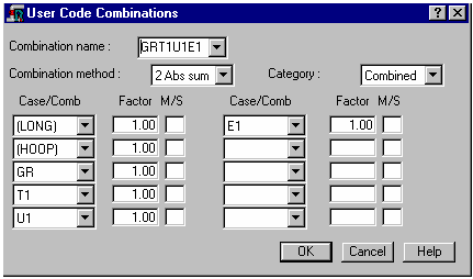

Step 2
If you wish to create user code combinations
a) Functional user code case e.g. Gr + T1+P1
See image below
b) Functional + environmental code case. e.g. Gr + T1+U1+E1
Note: the forces and moments for all load cases are combined at the moment level then an effective stress calculated and the allowable stress includes a factor =1.33.

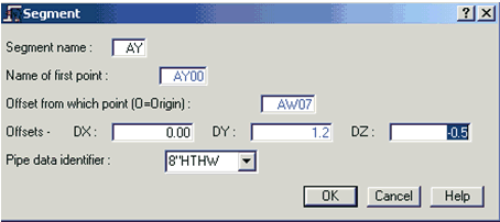

Some of my segments have been deleted from the model and using RE-NUMBER/ALL in AutoPIPE 6.0 some of the the point names do not match the segment names e.g. a AB01, AB02 may be on segment V, how can I correct this?
Answer: Currently in Autopipe 6.0 or 5.0x , the only workaround is or perform an Edit/Cut then Edit/Paste operation.
Select the complete model using Ctrl A or Select/All points such that all points are highlighted red, then select edit/Cut (ctrl X), clicked on or type the name of a base point for typically the first anchor in the system e.g. A00 then click OK. Click yes to delete all points and the model will disappear from the screen. Select Edit/Paste (ctrl V) from menu, uncheck the box "connect two selected points", then click OK. The complete model will reappear on the screen.

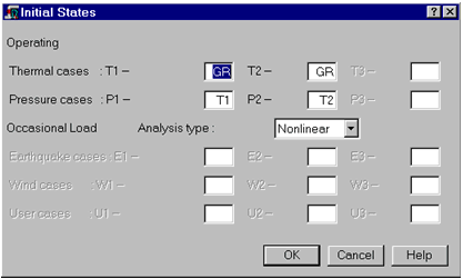

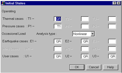

Why is my non-linear analysis giving unexpected results i.e large movements in the pressure case across my bellows when my tielink should restrain the pressure movement?
Answer: The tie-link has a large forward gap which under the default load sequence i.e default is "Use default sequence" is checked . Or to change the intial states i.e different load sequence then uncheck this option.
The following Initial states dialog shows the default load sequence.
i.e GR then thermal then Pressure case.
Since P1 follows the thermal case T1, the bellows moves across the gap under T1 providing "lift-off" or the gap is open then the pressure load causes the bellows to expand and moves back to take up the tie-link gap.
Further discussion on load sequencing is found in 5.0 appendices pg 190 or autopipe 6.0 Autopipe reference information under analysis considerations\static analysis\non-linear analysis\solution sequence
Note: The liftoff can be verified by checking the restraint loads for the tielink reveals Gr= -64500 and T1= 64500 confirming after the T1 case (gr+t1) no reaction occurs on the tielink hence tielink gap is open.s

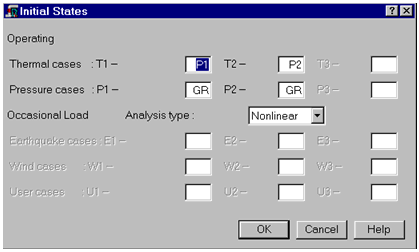

A more expected result i.e pressure occuring before the thermal expansion thus the load sequence of Pressure after gravity as follows:
Giving very small movements in the vertical direction = 0.002mm across the tielink (i.e A02-A01) is probably due to any rigid anchor or support does have a very large finite stiffness in the finite element analysis within autopipe.

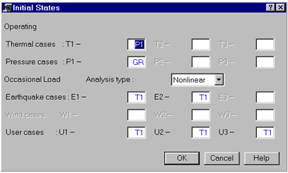

Preferred load sequence for correct loads on restraints
  1. You may wish to run a load sequence as follows which considers the earthquake cases after the operating i.e case of GR+P1+T1 and set T1 as the initial state of the E1 case. This equally applies to wind cases also.
  2. If more than one thermal case exists then the user may wish to set T1 as being the initial state for E2, E3 instead of T2 which may not be a operating case.
Regarding your Dx= 10mm in the E1 case since E1 follows Gr case in the load sequence and Dx = -5mm in Gr case the resultant position Gr+E1 is Dx= +5mm i.e hitting the gap hence the reaction in E1 case Fx = 179.

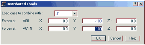

Snow and/or ice loading
Apply either :
  1. Select the range of pipe and apply distributed load (Insert/Distributed load) in the vertical down direction equivalent to snow or ice loading in the U1 case This is a uniform distributed load therefore enter as below:
  2. If all the model experiences the snow loading and same pipe size then can use a user-profile wind case in the -vertical direction if calculate the equivalent snow pressure to be applied i.e snow loading in lb/in divided by the projected pipe diameter (including insulation). Note: Wind pressure default units = lb/sq.ft.

How do I model the discharge piping accurately relative to my suction Piping?
Answer: To model the discharge piping accurately follow the steps below:
  1. Place the cursor on the suction point
  2. Insert / Segment (see screen bitmap below)
  3. Enter New first point name e.g AY00
  4. Enter suction point in the "Offset from which point" e.g AW07
  5. Enter offsets DX, DY, DZ
  6. Enter or select pipe identifier for the discharge piping
  7. Click Ok
  8. Then continue building the new discharge segment

Seismic load needs to be run with friction. How do I turn it on?
Answer: Go to Analyze/Static and turn on Gaps/Friction/Soil. Select OK. Uncheck the Ignore Friction for E1 to E10 box and select OK again.
