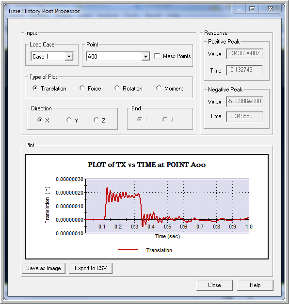

what I am really after is some assistance on dynamic modelling of the blast event.
I am applying a triangular blast profile over a very short time period which I am doing to each node of the affected pipe. To do this I am using a time force history and applying this to the nodes; some with a time delay.
I would like some more information on the best way of doing this and also, and most importantly, is it possible in AutoPipe to obtain a force time history of the reactions at the supports? At the moment, I seem to get just one force figure at each reaction which I assume is the maximum reaction force felt by that support.
Answer:
Internal Blast load:
By default, AutoPIPE reports only the maximum dynamic reaction force or response at supports. It does not directly provide full time-history reaction data in standard results output.
However, Time History Post Processor plots that are available in AutoPIPE version 09.06.xx.xx and later produces plot time-dependent behavior, where applicable.
When modeling short-duration (ex. impulsive, blast) loads, use the following best practices:
  • Increase the cut-off frequency to approximately 200 Hz
  • Enable automatic mass point generation up to 200 Hz
  • Consider, using the ZPA (Zero Period Acceleration) option to better capture high-frequency effects
For this type of load a static analysis can often be used as a simplified approach, however it may be conservative (up to ~2x response) compared to true dynamic results because of the dynamic amplification factor of 2.0.  Of course, static response will ignore phasing.
Static analysis is a good way to checking the dynamic results since it bounds the response results.

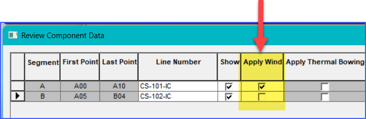

External Blast load:
To simulate a blast load acting on the external surface of a pipe, a Wind load case can be used as a practical approximation. Define a Wind load case to represent the blast force. Since blast effects are often localized, it may be necessary to divide/split the pipe into multiple segments to accurately apply the load only where required by using the Split Segment(s) command (Home > Operations > Segments > Split Segment(s). Again, this allows selective application of the wind (blast-equivalent) load to only the exposed portions of the piping system.
