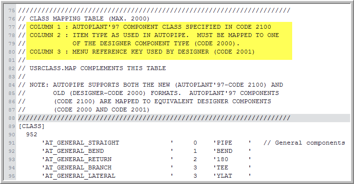

3. Open AutoPIPE CADAP.MAP file in any text editor (i.e. NotePAD, Ultra EDIT, MS WORD, etc..)
4. Search CADAP.MAP, CLASS MAPPING TABLE for item name listed after 2000 or 2100 (ex: AT_PIPE, AT_VALVE_BALL, etc.. ).
      'AT_PIPE                         '     0    'PIPE    '   // Base components
5. Scroll in the file to the top of the listing to see the section details:
Example:
// CLASS MAPPING TABLE (MAX. 2000)
// COLUMN 1 : AUTOPLANT'97 COMPONENT CLASS SPECIFIED IN CODE 2100
// COLUMN 2 : ITEM TYPE AS USED IN AUTOPIPE.  MUST BE MAPPED TO ONE
//            OF THE DESIGNER COMPONENT TYPE (CODE 2000).
// COLUMN 3 : MENU REFERENCE KEY USED BY DESIGNER (CODE 2001)
// USRCLASS.MAP COMPLEMENTS THIS TABLE
// NOTE: AUTOPIPE SUPPORTS BOTH THE NEW (AUTOPLANT'97-CODE 2100) AND
//       OLD (DESIGNER-CODE 2000) FORMATS.  AUTOPLANT'97 COMPONENTS
//       (CODE 2100) ARE MAPPED TO EQUIVALENT DESIGNER COMPONENTS
//       (CODE 2000 AND CODE 2001)
Based on this information,Column #2 identifies exactly what component the item is mapped too (ex. 0)

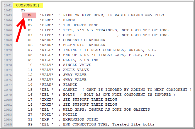

6. Scroll down to COMPONENT MAPPING TABLE,
Note: there are a total of 22 AutoPIPE components to map the over 1000's of AutoPLANT components too. Some of these AutoPIPE components have additional sub categories to address specific types of components that have some special features ( i.e. 17 different types of Supports components, 22 different types of component end connections, 15 different types of insulation, etc). But, remember there is only 22 different types of core AutoPIPE components to map too.
Continue by referring to the column information above this table that describes the meaning of each column in this table and then search column # 1 for the item number in above step (ex. 0) note in column #2, AutoPIPE component (ex. PIPE).
Ex: find "00   'PIPE'  : PIPE OR PIPE BEND, IF RADIUS GIVEN ==> ELBO"
7. Conclusion: AutoPLANT PXF AT_PIPE is mapped to a PIPE component in AutoPIPE.

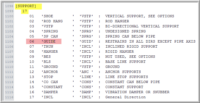

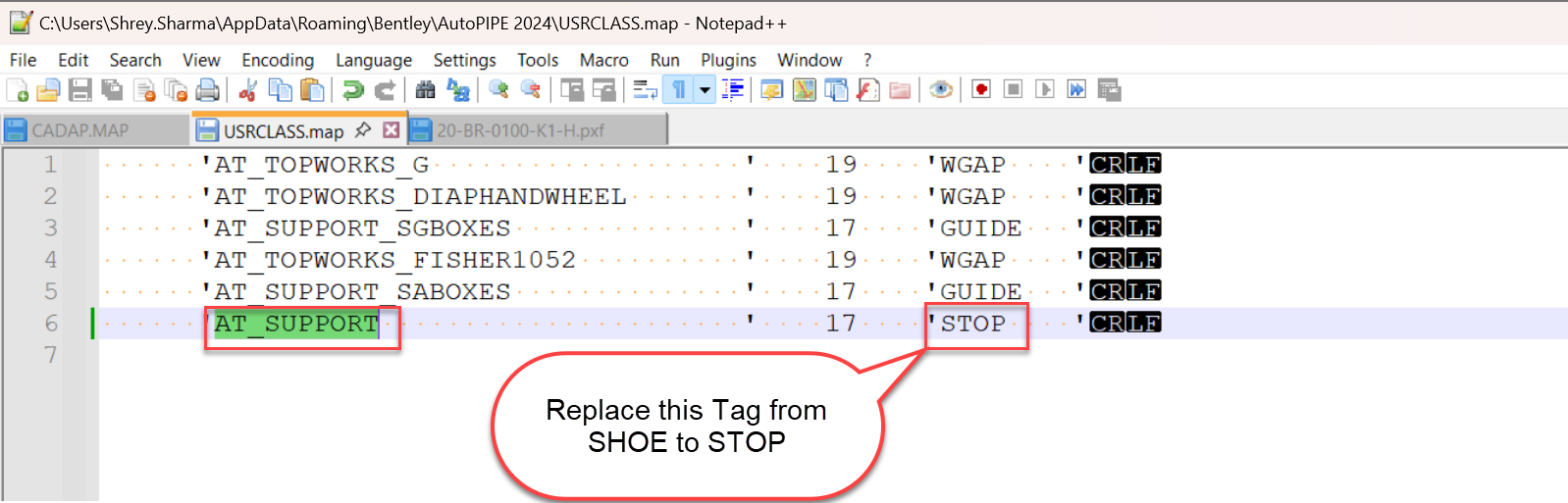

Answer: There are two ways to change the support type mapping:
    1. Suppose you want to map the tag name "AT Support" as Line Stop instead of V-Stop, please follow the steps below:
      1. Go to location C:\Users\User system name\AppData\Roaming\Bentley\AutoPIPE 2024
      2. Search for "USRCLASS.map" Open this file in a text editor (Notpad++., UltraEDIT, etc...).
      3. Go to "AT_SUPPORT" which you will see is mapped as "SHOE" which is a V-Stop.
      4. Now change this "SHOE" to "STOP" very carefully without changing any gaps/spaces.
      5. Now save this file.
      6. Import your PXF file you will see that all the support with tag "AT_SUPPORT" is mapped as a Line stop as shown below.
