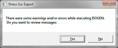

What do I do when the following appears?
Stress Iso Export
There were some warnings and/or errors while executing ISOGEN.
 Do you want to review messages:
Yes   No
 Answer:
Press the "Yes" button.
In a moment the AutoPIPE Viewer will be displayed with the following file:
C:\ Bentley\ AutoPIPE V8i SELECTseries\ PISOGEN\ PROJECTS\ APIPEPROJ\FINAL\ OUTPUT\ FINAL.MES
This file will provide details to the reason why the stress iso draw was or was not created. Fianl.MES file is updated each time after a Stres Iso command is invoked and drawing is created. Therefore it only contains information from the last successful run.
