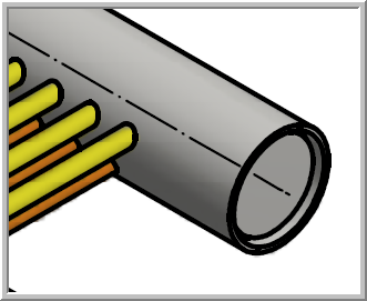

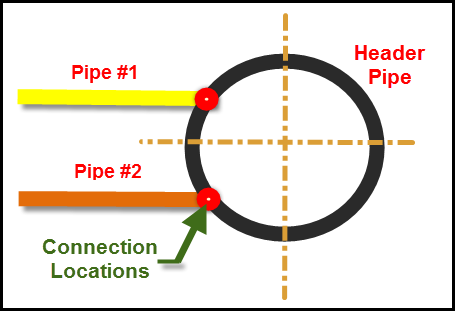

In this cases above the user will need to manually locate the surface of the header where the pipe will actually be welded. When inserting a new pipe run users have the option to use Cylindrical or Cartesian from the start point to establish the 2nd node point on the run.
Procedure:
1. Move cursor to header pipe node point (ex. A05)
2. Convert Node into a Tee
3. Insert new branch segment (ex. B) on tee (ex. from A05), extend new piping to Pipe #1 connection location (ex. B01), should be on the outside surface of the header pipe.
4. Insert additional node points on segment piping as needed.

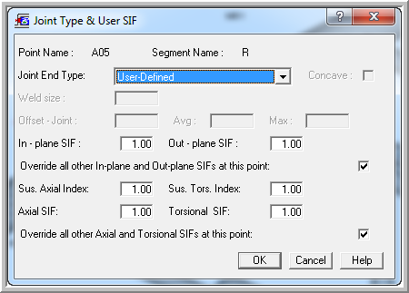

6. Select the header node point, Insert Xtra Data> Joint type and user SIF = user defined, "Override all SIF's at this point" - Checked ON.

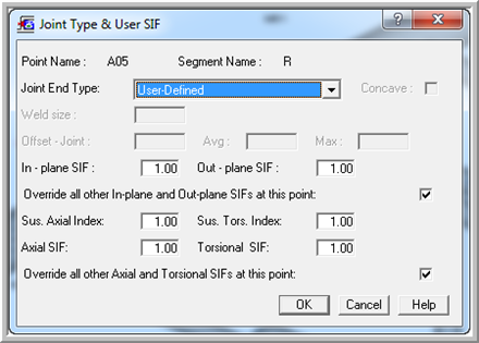

7. Select node point on surface of pipe where the connection is made, (ex. B01),  Insert Xtra Data> Joint type and user SIF, enter the correct SIF for the connection point, and again, "Override all SIF's at this point" - Checked ON.
