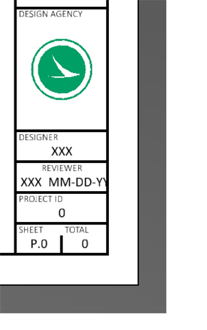

Ohio DOT's Sheet border has an area to place a Design Agency/Consultant logo. It looks like this:
The image above shows the ODOT Zephyr logo. The agency/company logo for the party responsible for each plan sheet should be used.
ODOT includes custom applications (OHDOT Sheets App & OHDOT Sheet Manager App) within the OHDOTCEv02 workspace to aid in the placement of these logo cells.
In order for these apps to see and use your logo cell, the following steps need to be taken:

- Ensure the logo cell fits within the Design Agency area of the title block. The box size is 1.5" long x 2" high.
- Also ensure the origin/placement point of the logo cell is correct. The custom apps mentioned above will place the cell in the center of the Design Agency box. The cell's origin/placement point will be the cell model's XY=0,0 location.
