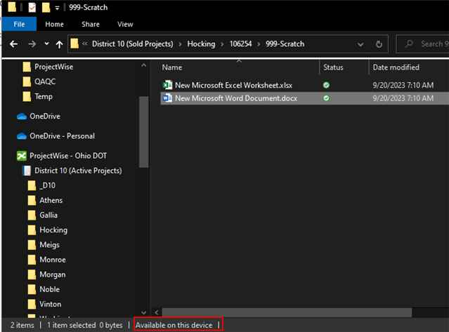

What do all the icons mean under "Status"?
If you do not remember what an icon means, one way to find out is to select the file/folder in question and look at the bottom left of File Explorer. This will tell you what the icon means.
You can also check out the below information provided by Bentley on what each icon means.
