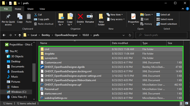

To make a backup of your user preferences you will first want to navigate to C:\Users\[Username]\AppData\Local\Bentley\OpenRoadsDesigner\10.0.0\prefs
Note: if you are starting from scratch or you've use the ODOT PW plugin to delete user prefs you will no longer have the 10.0.0 folder you will need to run ORD first before proceeding.
Highlight everything within this folder and right click "copy".

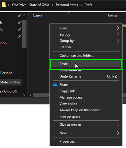

then paste these files to your choice location for access in future.
Tip: it is best to copy this to a folder so that you can always get access to these files if you ever start having function issue within ORD. As an ODOT employee it is recommended that you copy these files you your state onedrive to avoid using VPN.
