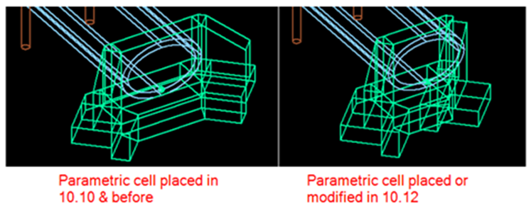

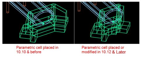

In ORD 10.12 & later, ODOT's parametric headwall cells (HW1.1_TypeA_Parametric, HWBC_TypeA_Parametric, HWBC_TypeB_Parametric, and HWBC_TypeB_RightAngle_Parametric) are not placing the wingwall angle correctly and/or if a headwall cell was placed in ORD 10.10 then modified in ORD 10.12 & later the wingwall angle is shown incorrectly. ODOT has filed defect #1281897 with Bentley. While we continue to work with Bentley for a permanent solution, a temporary workaround is provided below. Currently, this workaround is only recommended to be used in ORD 10.12 & later.

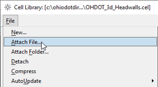

4. Once the Cell Library dialog is opened click on the File > Attach File… as shown.
5. From the Attach Cell Library dialog browse to and select OHDOT_3D_Headwalls_ORD1012.cel from the location below:

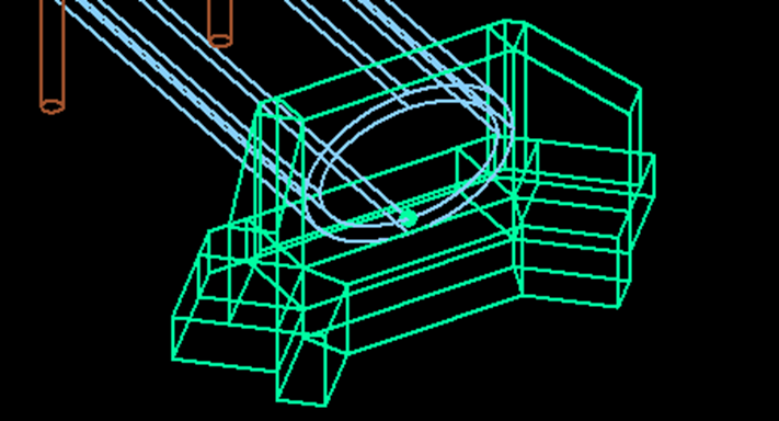

6. New cells can now be placed with the correct wingwall angle.

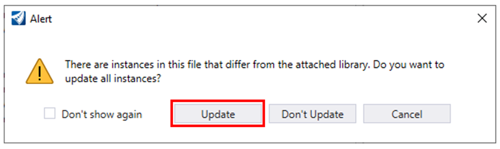

7. If a .dgn already contained a headwall parametric cell, the Alert shown below will appear.
a. Select the Update button.
b. The parametric cells that have already been placed should automatically update and fix themselves.
