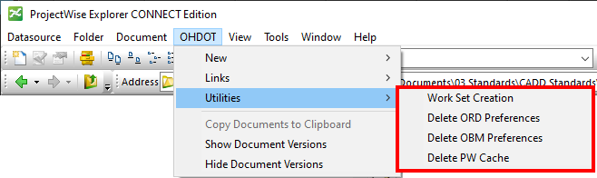

Reset User Preference ODOT ProjectWise tool bar.

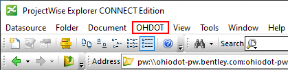

The OHDOT tool bar drop down can be accessed within ProjectWise Explorer.
Clicking the "OHDOT" tab.

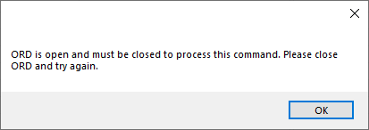

Highlight the utilities section and then select the corresponding user preferences you want to delete. Once you've clicked the desired preference delete you may get prompted with a message (shown below).
If you do get prompted with this message, just click the "OK" button. You may now open ORD once again and the software will generate a fresh .upf file.
Note: This process does have a safety feature and will not allow the user to run if ORD is still open on time of clicking tool.

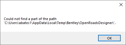

Deleting User Preferences using Windows File Explorer.
Copy and paste the path highlighted in blue into windows file explorer.
Note: You will need to add your [username] prior to clicking the enter button or the arrow within windows file explorer.
  1. Delete Folder: C:\Users\[username]\AppData\Local\Bentley\OpenRoadsDesigner\
  2. Create Folder: C:\Users\[username]\AppData\Local\Bentley\OpenRoadsDesigner\
  3. Delete Folder: C:\Users\[username]\AppData\Local\Temp\Bentley\OpenRoadsDesigner\
  4. Delete Folder: C:\Users\[username]\AppData\Local\Temp\Bentley\SUDA\
  5. Delete Folder: C:\Users\[username]\AppData\Local\Temp\Bentley\SUE\
  6. Delete Folder: C:\Users\[username]\AppData\Local\Bentley\SUDA\
  7. Delete Folder: C:\Users\[username]\AppData\Local\Bentley\SUE\

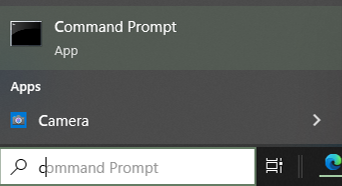

Reset User Preferences using Windows Command Prompt.
You can access the windows command prompt by typing "Command Prompt" into the windows search.

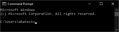

Once command prompt is open

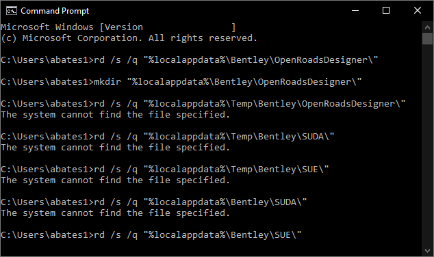

Copy the following commands and paste (ctrl+v) into the command prompt:
rd /s /q "%localappdata%\Bentley\OpenRoadsDesigner\"
mkdir "%localappdata%\Bentley\OpenRoadsDesigner\"
rd /s /q "%localappdata%\Temp\Bentley\OpenRoadsDesigner\"
rd /s /q "%localappdata%\Temp\Bentley\SUDA\"
rd /s /q "%localappdata%\Temp\Bentley\SUE\"
rd /s /q "%localappdata%\Bentley\SUDA\"
rd /s /q "%localappdata%\Bentley\SUE\"
