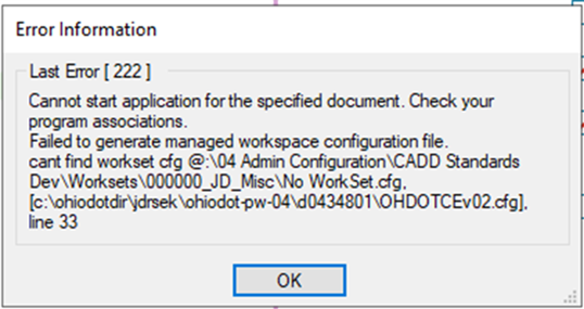

How do I fix the "Last Error [222]" message when opening a file in 10.12?
This wiki will cover some of the workarounds and solutions on how to fix the ProjectWise managed workspace error "Last Error [222]" (shown below). This only happens when loading a different workspace than the previously loaded configuration with a CONNECT product using power platform Update 17 or higher (for ORD this would be 2022 Release 1 (10.11) or newer) which is causing it to break the managed workspace. This error was introduced with MicroStation CONNECT Edition update 17.

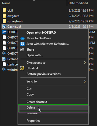

Solution 1 (Temporary & Manual Fix)
This will require you to navigate within windows explorer to delete a cache.ucf file. Follow the steps below.
First navigate to the windows task bar and select the   Windows Explorer icon and right click.

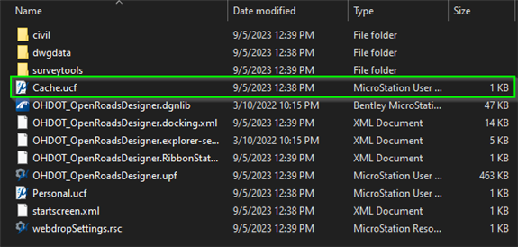

Next drill down through the  Windows (C:) by going to C:\Users\[username]\AppData\Local\Bentley\OpenRoadsDesigner\10.0.0_X\prefs\
(Note: the _X may vary depending on how many side-by-side load versions of ORD you have on your machine.)
Select and right click the Cache.ucf file and select the delete option.
Now that once the Cache.ucf file has been deleted you should be able to open the file again without the "Last Error [222]" dialog popping up. Note that this is not a permanent fix. This file will get recreated every time you load ORD and the error will return the next time you load a different workspace from the previous loaded configuration.

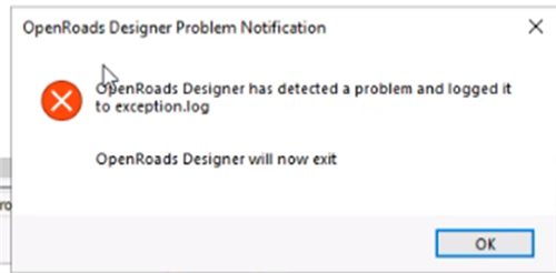

We have noticed in some cases that the below error message is shown when closing the file.
