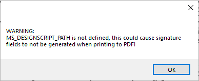

If you get the below warning message when launching this app you need to define the MS_DESIGNSCRIPT_PATH variable within the specific workset cfg file BEFORE you use this application!!! See below video for more details.
MS_DESIGNSCRIPT_PATH = $(_USTN_WORKSETROOT)990-WorkSetStandards/Plotdrv/
https://youtu.be/tM3YInTvKNw
